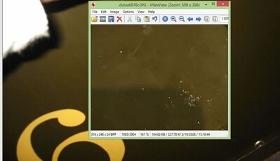

Putting the WM colors aside for a moment, Eric, but by any chance did you see this?...
There's a guy on eBay selling a gallon of Dulux Automotive Enamel mixed for 5502 Pullman Green...
https://www.ebay.com/itm/267612925769
He's also offering a quart of another Pullman-type Green with the DuPont code of 6976...
https://www.ebay.com/itm/267612942661
I don't recall seeing that number before but 6976 looks a lot like the old Reading olive green...
