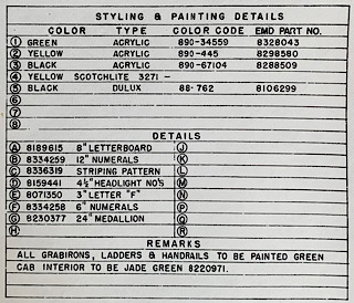

I have this chart from EMD Styling & Painting Diagram ## 8446040 dated 4-14-70.,
That diagram is for Ashley, Drew & Northern 150, an SW1500 that the AD&N purchased new from EMD.
I’ve looked through all the references that I can find and cannot locate the numbers for the Yellow and Green that are in this chart. So that I can cross reference them.
If you look on this Condren Rails page and scroll down to the third picture from the bottom, you will find a picture of AD&N 150 in this scheme on October 26, 1975.
https://condrenrails.com/AD&N/index.html
Any help would be appreciated.
Thanks,
Tad
 Post subject: Re: Railroad Color Library
PostPosted: Mon May 24, 2021 9:26 am
Posts: 2057
Tad - let me check on these for a cross, though I don’t think I have them. Your “Refer.” column is the DuPont product and color numbers. The EMD column is the color in the styling book which will reference back to the DuPont number. Sadly, the DuPont numbers are no longer valid and can’t be crossed to current formulations. I’ll do a little digging and see if I come up with anything. For future reference, I’ll add these to the list in case something pops up later.

Thanks, Eric.
I looked all through your list and every other reference that I was able to find hoping that those had been used by some other railroad.
Eyeballing it, I think I could come “almost close,” but I am fixing to get some decals made and need to make a decision on the colors that I am going to use for that scheme.
This is for modeling purposes. My intent is to model the entire AD&N diesel roster in N scale. There were nine units painted in the yellow and green before they renumbered and repainted into the green and white scheme.
Mr. Tedder, the former president of the AD&N, told me that they used BN green for that scheme. Sadly, he is no longer around to consult with.
Thanks for taking the time to look into it.
Tad
PostPosted: Wed May 26, 2021 5:03 pm
Posts: 2057
I've exhausted all my sources for cross references and can't find any references to the DuPont 34559 green and 445 yellow. I don't have access to any EMD swatches so I can't look for a cross there though they'd likely point back to DuPont.

In looking back through my stuff again, I found that I also have EMD Styling & Painting diagram # 8336318 for AD&N 178 dated June 12, 1963.
The chart from that drawing looks like this:
The DuPont color codes are the same, but the prefix is different. The EMD numbers are also different. That may just be a 7 year thing.
AD&N 178 is the other unit in the Mike Condren photo referenced above.
I guess from “eyeballing” that I am probably going to go with Reefer Yellow and CNW Green.
I think that they are almost close.
Thanks again,
Tad

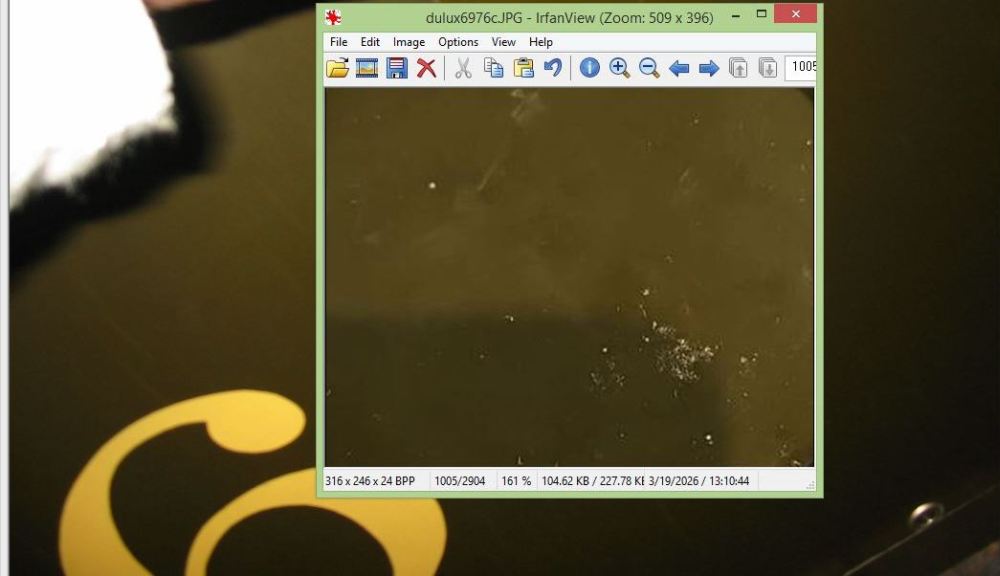

Putting the WM colors aside for a moment, Eric, but by any chance did you see this?...
There's a guy on eBay selling a gallon of Dulux Automotive Enamel mixed for 5502 Pullman Green...
https://www.ebay.com/itm/267612925769
He's also offering a quart of another Pullman-type Green with the DuPont code of 6976...
https://www.ebay.com/itm/267612942661
I don't recall seeing that number before but 6976 looks a lot like the old Reading olive green...
