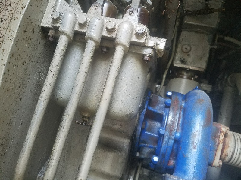

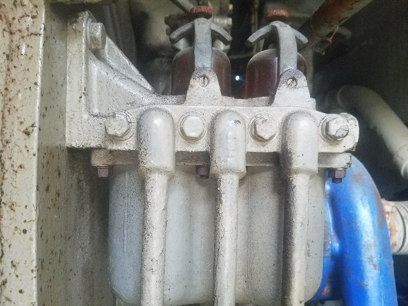

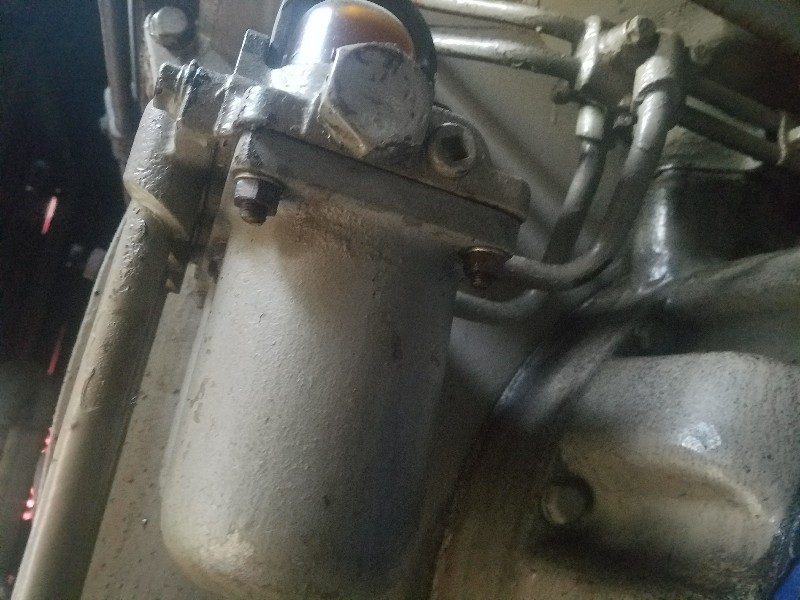

I am hoping to find some information here, as I haven't been able to anywhere else. I have also searched the forum to see if it had been discussed before.
I am currently leasing an SW with a 567B engine. It has the old canister style fuel filters. I have not had a chance to change them to see if they are still available, but regardless I would like to upgrade to spin on filters for ease of maintenance and to help the owner out (good friend of mine). I have seen other 567B's with spin ons, I just currently don't have access to go look and see how they modified it. I would think the mounting plate either needed to be changed, or there were adapter discs that were bolted on and then the filter mounted on that.
Anyone have any suggestions or pictures of their setups?

The conversion requires qty. (2) 8423132 spin-on filters, qty. (1) 8423131 adapter plate, and qty. (1) 8423130 gasket. The cost of parts was $16.29 on November 3, 1969 when the kit was announced in EMD Pointers. This assumes the engine previously had the type of filter with eight nuts and studs, these are re-used to mount the new adapter.

I will call this week and order parts, I just thought posting pictures of the current setup and then adding pictures of the conversation later.

One thing to keep in mind is the old style filter upper has the relief valve behind the large hex. These are prone to sticking and the result is typically a shattered secondary sight glass with the resultant fuel spill. Best to remove the shuttle and use modern 10 and 60 pound relief valves. The engine will continue to run with a shattered secondary sight glass until the tank is empty.
EBL
 Post subject: Re: EMD 567B spin on fuel filter upgrade
PostPosted: Mon May 07, 2018 1:32 pm
Posts: 209
Location: Liberty Hill, SC
Thanks EBL,
I have heard of that happening but never the cause-
I will take precautions to keep that from happening.
