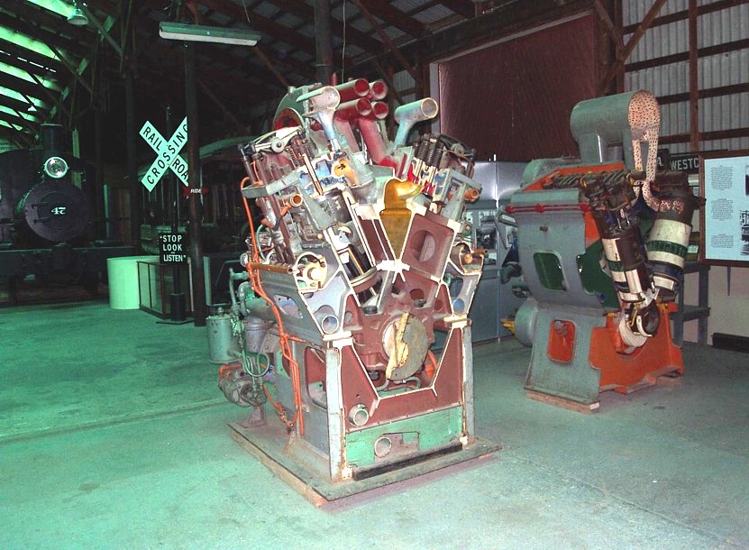

 Post subject: Re: Cut-Away Locomotive Exhibits *PIC*
PostPosted: Fri Oct 18, 2002 1:13 pm
Kurt,
The Rochester Chapter NRHS, which operates the Rochester & Genesee Valley RR Museum, has two cutaway diesel locomotive prime movers. One is an Alco 244 and the other is an EMD 567 I believe. As you can see by the picture, they are not complete engine blocks, but are comprised of part of the complete block showing the cylinders and valves and many of the other detail parts on each end of the engine. The 244 shows a cutaway of the turbo showing its insides for example. They are all painted and are very well done. Even though they are not complete blocks, they are still quite massive taking up about 5 feet by 5 feet of floor space and standing almost 7 feet tall.
They are currently on display at our partner museum, the New York Museum of Transportation, since the R&GV RR Museum does not have a display location large enough. I am not sure where they came from, but they are well done and have been on display for many years.
