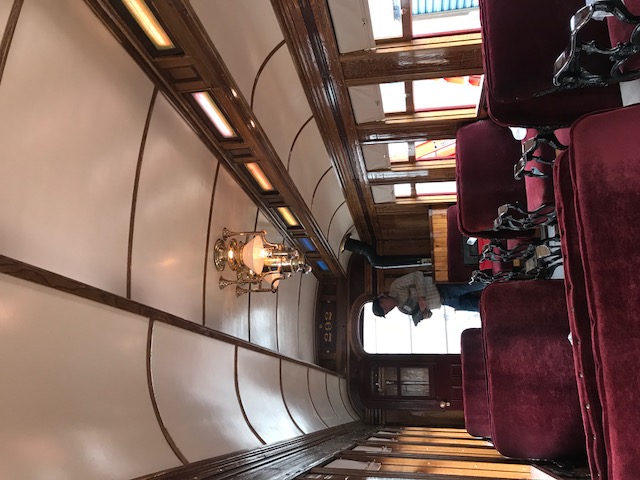

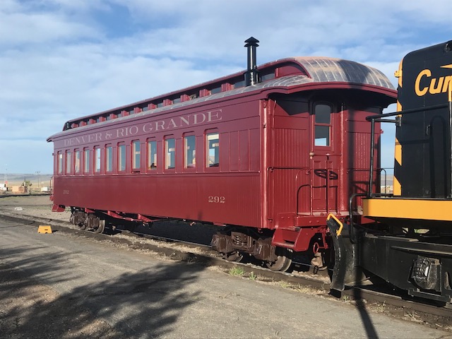

The special projects department has completed the first of four 1880s wooden coach rehabilitation’s this week with the roll out of Jackson and Sharpe built coach 292. A 17 month project funded by state historical foundation grants, the project was conducted according to Secretary of Interior standards to a period of significance c. 1916. This historic consist will be pulled behind DRG 168, an 1883 4-6-0 built specifically for passenger service. We are in the process of grant writing and fundraising for the new passenger trucks required for the historic fleet as these cars all lost their trucks as they were downgraded to work train service in the mid 20th century. As such, all these cars arrived in seriously deteriorated condition. My thanks to my team in special projects for all their hard work turning out this beautiful work! Coach 256 is the next project and all funding is lined up for this project, which is expected to take two years. Thank you for your interest and I hope to see you all in narrow gauge country soon!

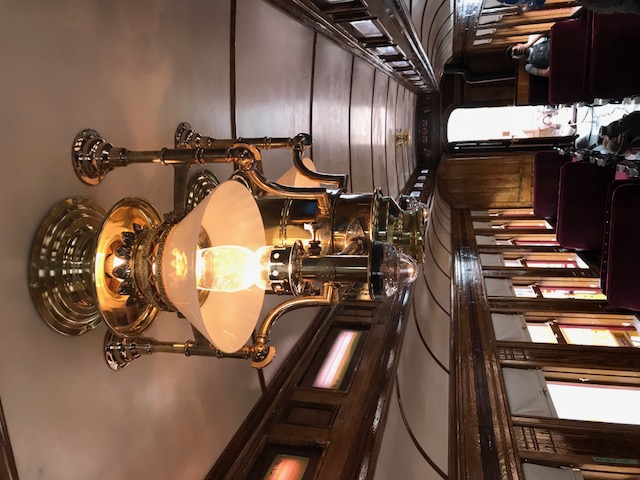

Can you tell me about those interior lights? Are they original or repros? Are they the type originally used in the car or "representative"?

The lamps are exact replicas of Adams and Westlake 91 1/2 coach lamps that were standard for DRG coaches. Although not inexpensive, these were made by WT Kirkman and turned out beautifully. I chose to also have an led added to the smoke bells to illuminate the chimneys, an effect that is very convincing. Although everything is present to potentially burn these lamps, I did not want to risk the artifact with open flame.
