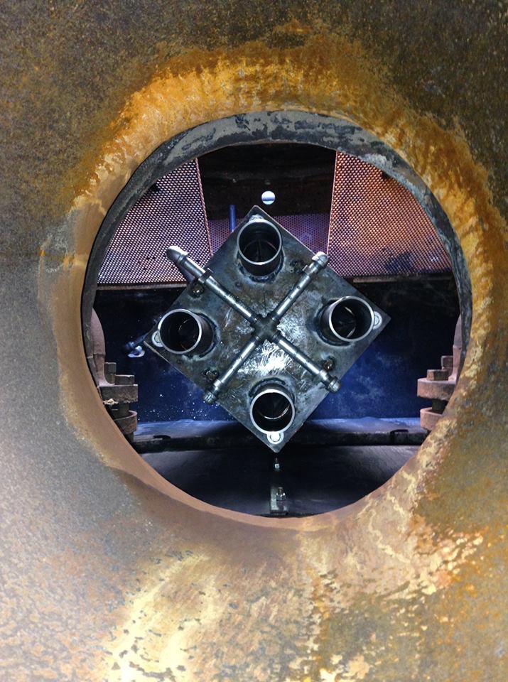

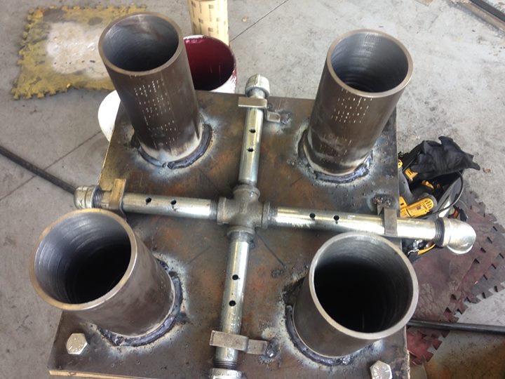

My friend Michael Guy has been working on a new front end arrangement for Essex Terminal #9, a 1923 vintage 0-6-0 at the Waterloo Central Railway. I asked him if this was a lempor type exhaust, he replied
"No, it looks similar but is different. Lempor theory includes a mixing chamber which is not necessary and also includes in its calculation secondary gas mass flow from the boiler tubes which has been shown conclusively to be an error. Koopmans has updated the whole thing and has been able to take historic test data and match it to the recorded test results something the engineers of the day were unable to do."
He went on to say,
"In response to feedback asking exactly what the heck we did to loco #9 exhaust on WCR: We removed the 1923 single blast nozzle and the double petticoat pipe above it and replaced it with a 4-nozzle exhaust correctly located just below the stack inlet flare. The calculations to size and place the nozzles were done by Dr. JJG Koopmans in The Netherlands; I drew up the new arrangement and added the blower. Construction work was split between my Elmira shop and the WCR St Jacobs shop. The relevant theory is that short, fat exhaust ejectors don't work as well as long, thinner ones. This arrangement breaks the single stack up into four smaller ones, essentially four separate chimneys with the unnecessary intervening walls removed. The benefit is that the vacuum developed in the smokebox is higher and the draft through the firebed is correspondingly greater than that developed by the old arrangement. A secondary benefit is the total exhaust area can be larger than before realizing a decrease in cylinder back pressure and a corresponding increase in tractive effort by the engine. The only other steam locomotive in existence with this front end design is King 6023 in the UK. Testing of #9 is in early stages but we are very pleased with our success so far."

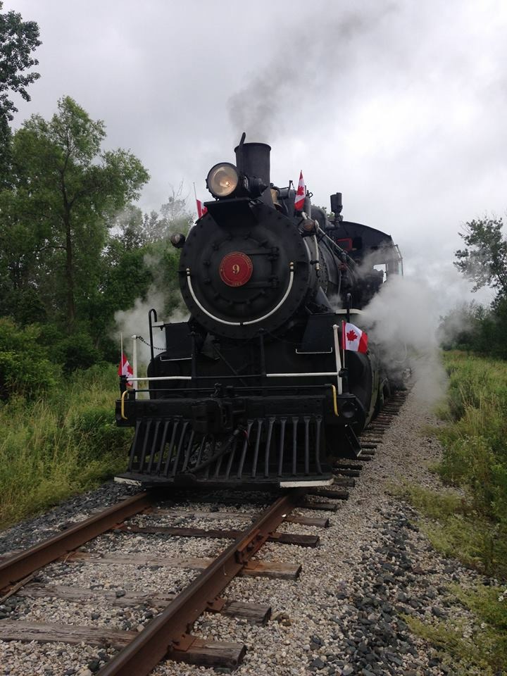

In case you were wondering, this is how she looks on the outside :-)

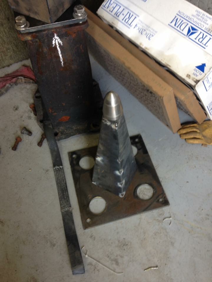

Posts: 546
Location: Canada
TrainDetainer wrote:
Interesting. So what's in the box? Is there a baffle/splitter arrangement of some sort? Got pics? And with the top of the nozzle just below the stack inlet, the goal for the gasses is to meet at about two thirds stack height, or just below the top? The nozzle pipes are machined - outward taper or just roughed up to break up the stream?
Here is a picture from Michael of the internals before being welded together...
