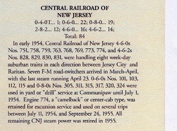

Hi Bernie
I not sure if this is the answer you are looking for, but this is from a paperback book called America Steam Finale 1955 - 1970 by Lloyd E. Stagner first printing 2001.
File comment: From Book America Steam Finale by LIoyed E. Stagner
