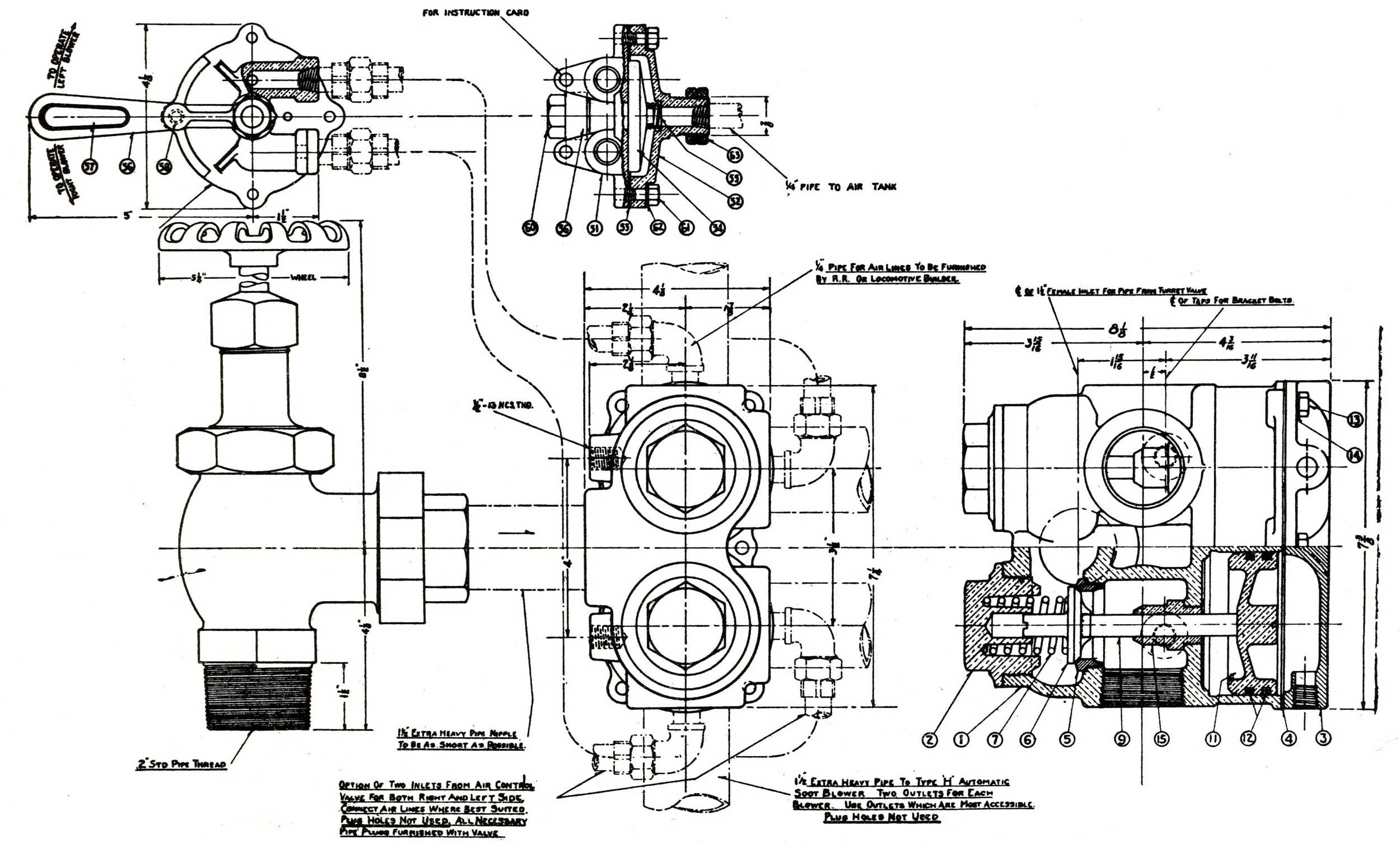

Does this set you right?
Superior Automatic Soot Blowers.pdf [393.55 KiB]
Downloaded 1298 times
 Post subject: Re: What are Superior Soot Blowers?
PostPosted: Wed Jun 20, 2018 2:55 pm
Posts: 1118
Location: Warszawa, Polska
Also, this:

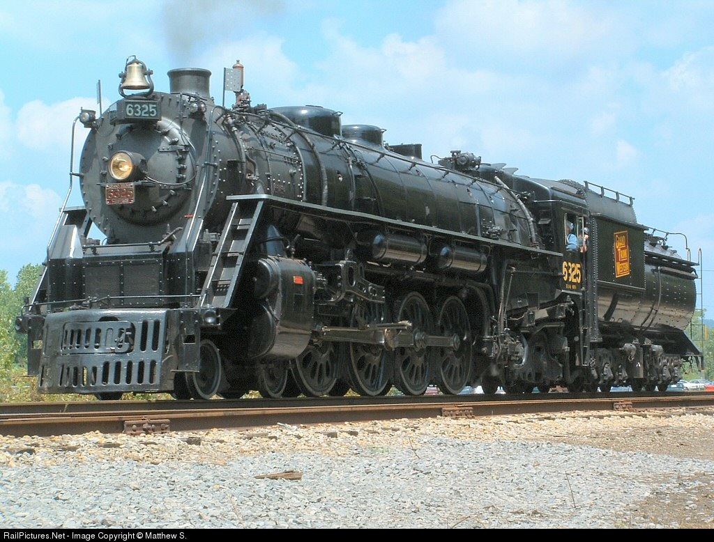

I rebuilt a pair for our GTW 4-8-4 #6325 back in 2000. You can see the fireman's side in the picture just above running board behind second air tank.
We rebuilt them back to the drawings and they worked for awhile. You would run them prior to coming into station to clean the tube sheet. It would turn stack dark for a few seconds and then clear again. We typically ran Pocahontas Coal, so smoke and ash were not much of a concern for us. They were neat but hardly ever used. I am not aware of any other engines running with them.
After awhile, they would just blow steam, they would stop oscillating up and down. We never bothered to tear them apart to see what needed to be done. I am sure it was some debris inside on of the slide valves stopping the steam passage. I have a feeling that is what happened back in the days of steam and they weren't used much.
I have to think a smooth talking salesman sold the railroads at time to keep people happy at station stops. In theory it would be a good solution, reality is much different.
