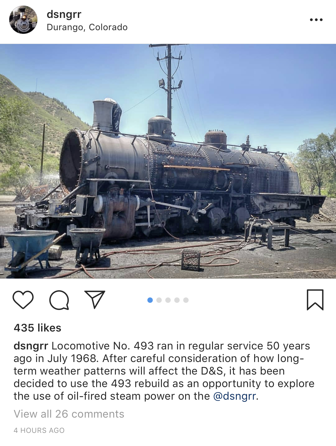

Well, I don't know if this is technical and interesting enough, Dave, but I would venture that their power ought to run pretty good on oil, if they copy the Baldwin standard burner, brickwork, and plumbing setup we used on our 2-8-2s in Guatemala.

With respect Cat Daddy, I think they would do better to adapt the SLM / Sulzer light oil system rather than go back to the bunker C era. Much cleaner, fuel more readily available, and far less likely to shell carbon out or set firepan fires. I'd hope they are in touch with Roger Waller...….

FWIW, Short Line Enterprises converted 1888-built Dardanelle & Russellville 4-4-0 No. 8 from coal to oil back in about 1975-6 for operation on the new Virginia & Truckee. After they operated if for a while, they figured out they needed a stronger blast with oil than with coal and reduced the nozzle by about 20% area. It subsequently operated for 21 years at the Nevada State Railroad Museum--on old crankcase oil, heating oil, and the occasional shot of diesel--and was a joy to fire.

Couple quick comments:
The old Baldwin system works with pretty much ANY type oil product or waste, unless you mean gasoline or propane.... BUT that Sulzer system works fine, too, they have a "Super Kriegslok" on the Vollernbahn (not sure of exact spelling) that runs great using it. The Krupp locomotives we had in Guate used a three burner system that was very well liked when they were new. They we retrofitted with Baldwin system only because parts for the Krupp system were no longer available.
Properly operated oil burners DO NOT leave a smoke trail.
