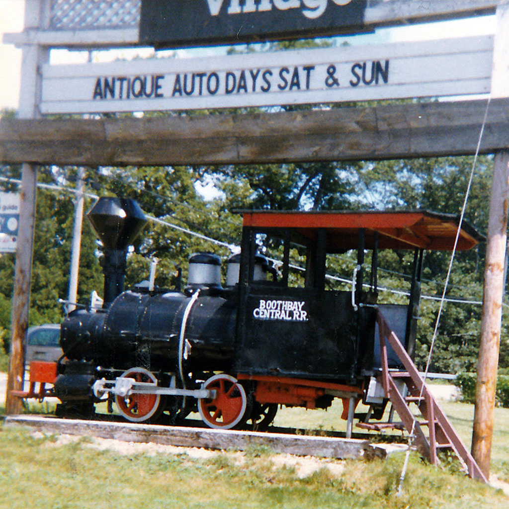

Wasn't this locomotive basically a billboard for the longest time?

There's 2 of them at Boothbay, both went elsewhere after the SD Warren paper mill in Westbrook got rid of their two-foot plant railroad, were converted to be a gas engine (non-steam), then returned to Maine. #1 is currently underneath the canopy at the back of the property, #2 was the billboard then was pulled to be restored. You can still see the chain drive underneath #1.

Also, for a comparison, here's she is the first time I saw her, doing billboard duty back in 1984.
File comment: S.D. Warren no. 2 under the sign at the entrance to Boothbay Railway Village, July 1984

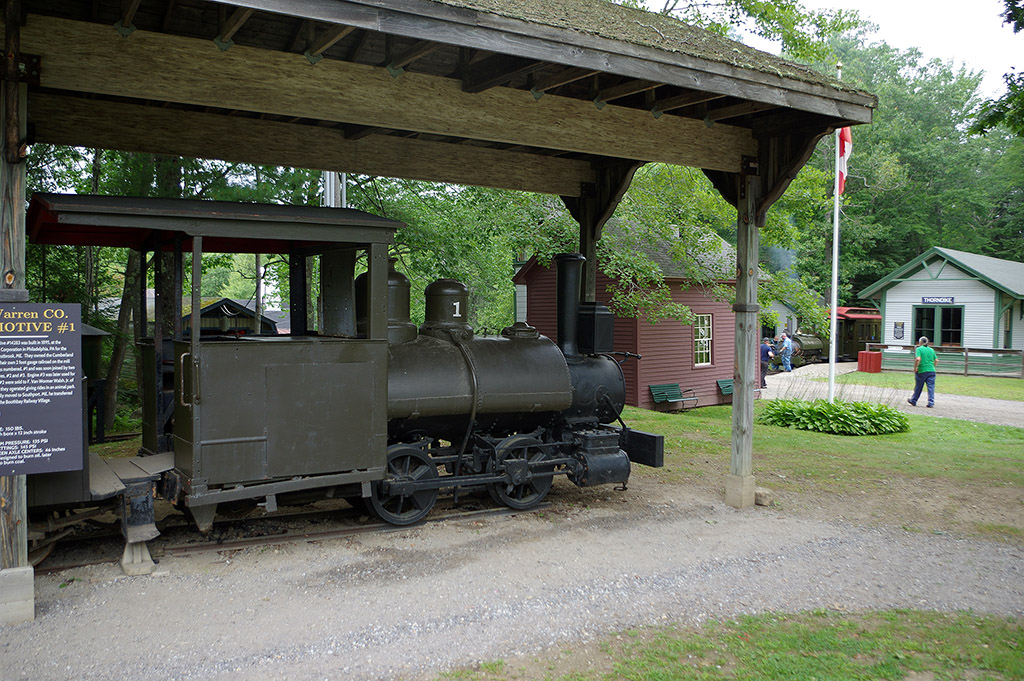

With the return to service of no. 2, sister engine no. 1 now has the distinction of being the only remaining historic Maine two foot gauge steam locomotive that has not steamed in preservation.
File comment: S.D. Warren no. 1 on display, with no. 2 steaming in the background.

So how were these engines motorized? Gear on the rear driver with a small motor in the firebox?

Yes, the firebox was cut away inside the cab and a gasoline motor was installed, with a chain drive to the rear axle. No. 1 has a four-cylinder Ford motor in her, which I recall was exposed when I was there in 1984. It's now covered under a plywood box, but I believe it is still there. The gear and drive chain is visible under the cab. No. 2 had a different engine (but I don't recall what), with the original Johnson bar being used as the shifter! They were converted by the previous owner, a theme park in New Jersey, soon after they were acquired from S.D. Warren. I heard the theme park tried running them on compressed air for a short time before they were motorized.
