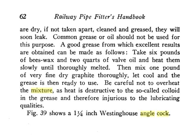

From the Railway Pipe Fitter's Handbook, Simmons-Boardman, 1925. You may want to scale the recipe down a little...

I wouldn't over complicate anything here - it's an angle cock. Vaseline and graphite worked for years. The General Foreman of the Central RR of New Jersey thinks the bees wax, valve oil and graphite mix is better. Graphite is the key ingredient. What the graphite is mixed with just holds it in position on the surfaces to be lubricated and it would be nice if it's not acidic. Or, just put a little M-914 brake cylinder lube on it. You should have some from doing COTS. If not, I'm sure Multi Service would be happy to sell you a 5-gallon bucket. Railroad tools will sell you a single 14oz tube. https://rrtools.com/product/grease-brak ... -Y0lrYrEFZ
