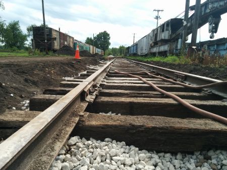

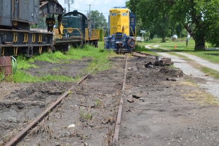

After many years, 10 at least, of deferred maintenance (actually none), Orrville Railroad Heritage Society has finally gotten a start on track rehab at our DABO facility. The only previous work that I'm aware of was the emergency repairs three years ago to pin a section of track together enough to shove our equipment in when we had to move.
We're aiming to eventually get enough work done to be able to give short train and speeder rides, and once the wrecker is fully operational, demonstrations with that (as well as being able to move about and pick up heavy scrap scattered around).
A good portion of the side tracks are buried in foundry sand, likely to facilitate the previous scrapping of railcars, so a fair amount of digging is involved just to find out what we have. While we were expecting a "peek & shriek", overall, the track isn't as bad as we anticipated though not as good as we could have hoped.
The work consists of jacking, leveling, aligning, ballasting, tamping, tie and rail replacement - mostly with a backhoe/loader, ancient pneumatic spiker and tamper, hand tools and blisters. If the track fairies magically delivered a tamper and regulator some night, we'd surely appreciate it.
The first image below shows what we started with , the second where we're at so far.
File comment: Weeds stripped showing rails in sand and dirt.

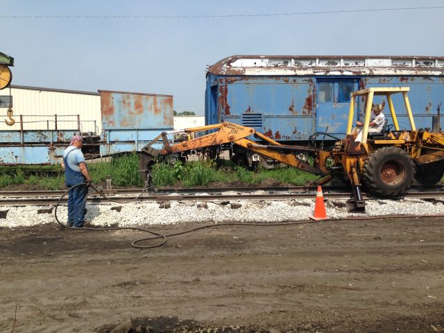

Track work continues. In this portion, we had to raise it almost 12” to remove an 80’ long sag. Necessity being the mother of invention, we modified a jackhammer and clamped it to the trenching bucket to use as a tamper since we broke the bit in the smaller hand tamper – twice. Seems you can’t weld tool steel with a small welder and expect it to last with a lot of abuse. We’ll go back to the smaller tamper once the new parts arrive. We’ve almost completed about 100 yards of track in a month of working most weekday mornings.
