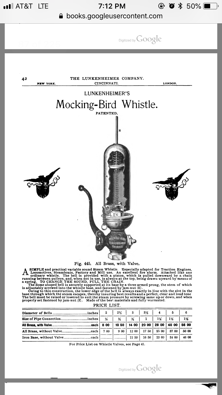

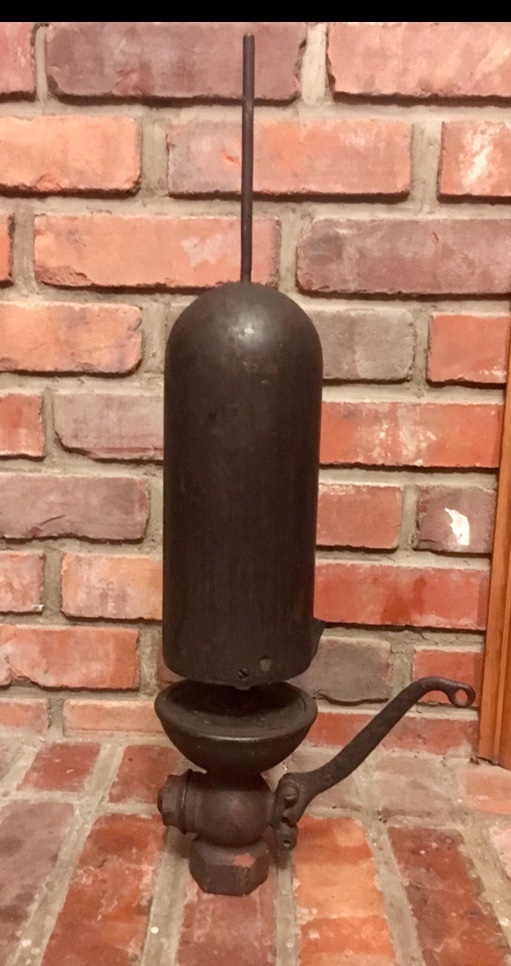

Can anyone provide information on this mockingbird? Trying to determine year. I’ve found the design in the 1895 catalogue and it seems to change in the 1906 catalogue to a different design. Any thoughts on the year and value?

That would have been a catalog item and thus would be hard to pin down an exact year of production.
Whistle collectors call them "Fire Alarm" whistles.

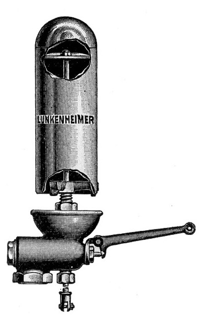

I've got an 8 inch version of a Lunk fire alarm whistle... and this drawing shows how they work. I've had mine plumbed in to a 125psi steam system, and it was awesome loud!!!!
Here is a video of one working. https://youtu.be/YDRifhelQM4
Yours doesn't seem to have the correct valve to be bottom operated... does that rod that looks to be coming out of the top of the dome actually move a disc on the inside of the bell?

Bad order and Tom,
Thank you for the information. As for the valve, the earlier versions used the kind pictured based on what I can see from the catalogue. It does have a plate that is connected to the rod. Mine is missing the chain that would be pulled to move the plate. But it moves and springs back as it should.

This maybe the US patent covering the 1895 version -
https://patentimages.storage.googleapis ... 476472.pdf
When the piston is in its uppermost position as shown in Fig 5, the bell will give forth its deepest tones and will sound a higher and higher key as it is drawn down toward the lower end of the bell.
A much later patent - Grant US1288798A Jerome J Aull Lunkenheimer Co
Priority 1915-08-09 • Filing 1915-08-09 • Grant 1918-12-24 • Publication 1918-12-24
The compartments in this type of whistle are of different depth, thereby giving a different pitch for the sound of each compartment, resulting n a harmonic sound of several notes. In whistles of this type, the parts have been constructed in the past with bells of brass or bronze, and the valves … https://patentimages.storage.googleapis ... 288798.pdf
also seems to have a variable pitch
Does the whistle have a patent number anywhere?
