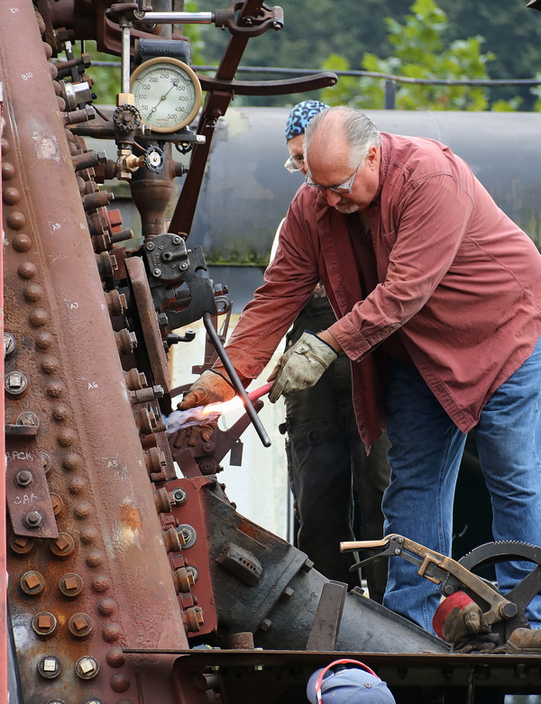

This morning ( Tuesday, October 02, 2018 ) at 11:19 am. Gary Bensman lit the first fire in Western Maryland Scenic Railroad's ex. C&O #1309's firebox. The locomotive still on a shop truck and it's trailing truck was outside the rear of the shop this morning for the fire-up.
Photos later after I download the camera.
Tim Wilson

Photos taken at Ridgeley, WV - 02 October 2018

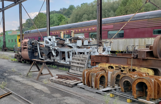

Does anyone know if the drivers and boxes are essentially ready to go back under the 1309 yet?
Rob Gardner

Congratulations to WMSR and everyone involved on the first successful steam test!
RookieFireman wrote:
Happy to see a milestone reached in this restoration. The 1472 clock starts now.
Was there any support underneath the middle of the boiler? Hard to tell from photos.
Isn't it the case that the clock starts ticking when the first tube is rolled in, not the first fireup?
Looking at "Smoke01reduced.JPG" and "smoke02reduced.JPG", if you zoom in, it's pretty clear there's no intermediate support. However, speaking as a mechanical engineer, while not ideal, since it's stationary and not seeing regular service like this, it should be just fine.
Don't think so at this very moment, but I'm sure they've got a plan for them. These pics were from almost 2 weeks ago:
1309 will be coming into service lettered for "Western Maryland", not "Chesepeake & Ohio". Eventually, 1309 will be lettered/numbered as Western Maryland #960.
