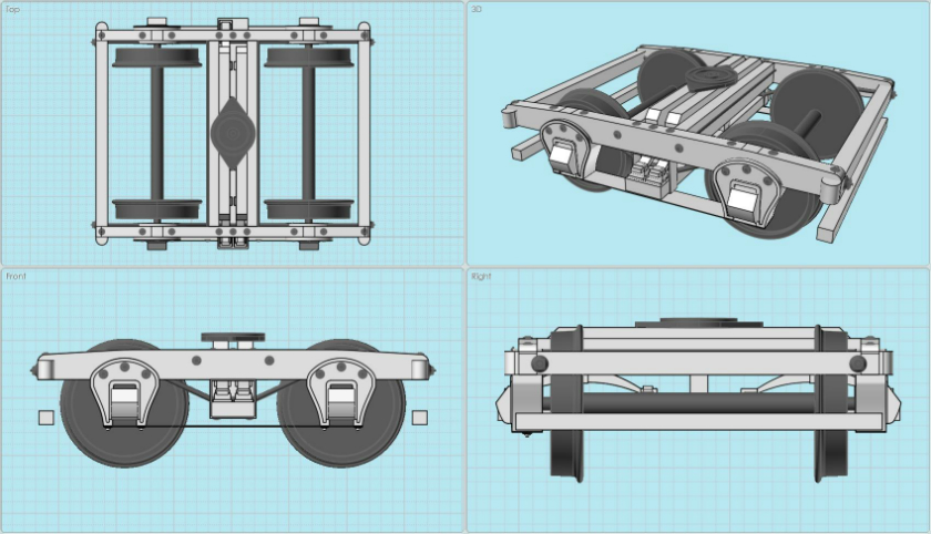

Hi folks. Would anyone have access to drawings for early PRR freight cars from the 1867 period? I am currently working on the trucks for this equipment, and I would like to recreate proper rolling stock.
Thanks
Chris

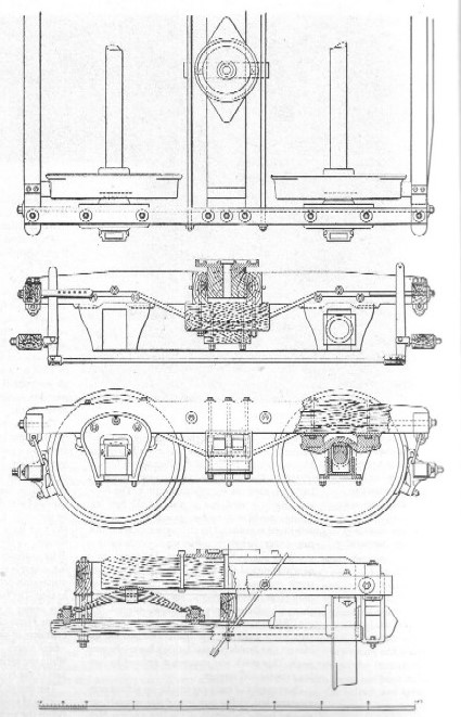

Have you checked John White's book, The American Railroad Freight Car? I am not sure if it gets back to 1867 for PRR cars, but it might have something you can use. I am curious about your drawings for the USMRR trucks. Do you have historical drawings for those trucks which show all the hidden details? They appear to be swing motion trucks conceptually.

Based on this drawing. Has been updated significantly since the snapshot I posted.
C.

I think Chris had originally labelled the file USMRR trucks, but they are credited in White's book as 1867 PRR trucks, which is why he's looking for PRR equipment drawings.
Also, the PRR trucks in the original drawing are floating bolster design, not swing motion. It is interesting that this stated PRR 1867 design, if true, came about at least 4-5 years after the USMRR was buying better, higher capacity trucks.
