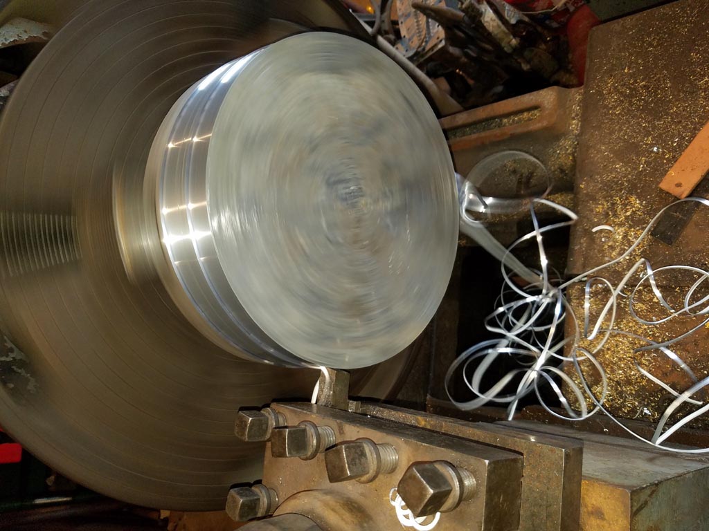

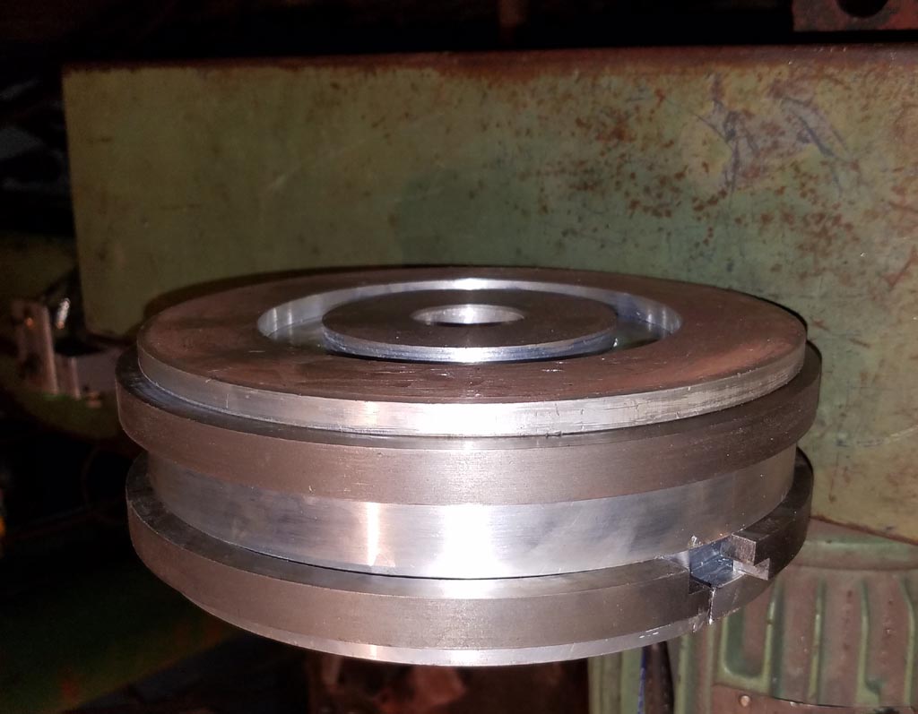

We have had good luck with aluminum. I recently made some for an 11" cylinder that I bored 50 over and 7 1/2" that was 70 over. The aluminum does expand more so have to figure that in the clearances. It works well to replace cast iron pistons that are hollow to avoid excessive weight.
Chris

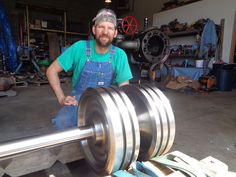

Dura-Bar G2
File comment: Hal Fuller-style spool-type 17" Skinner Unaflow piston by Cascade Hydraulics (Brian Fleming) Longview, WA
 Post subject: Re: Piston Material
PostPosted: Sat Dec 15, 2018 9:04 am
Posts: 110
Wow! Those pistons are beautiful. Look better than most public art installations.....
Thanks for the inspiring photo.
Bob D.
