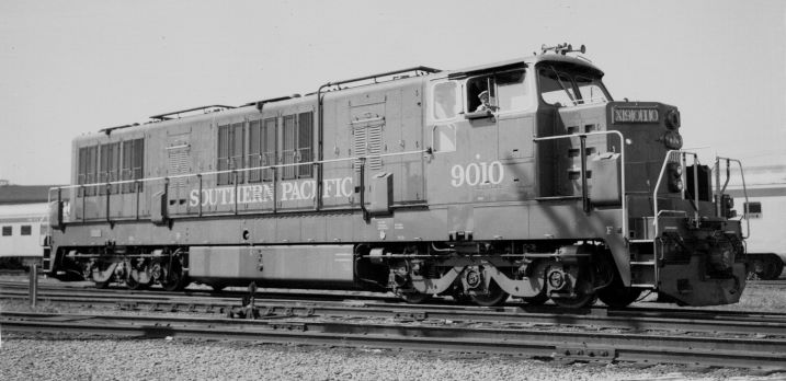

The crew restoring SP 9010 had such a quandary, when the unit was painted in Germany when new, the "kerning" of the road numbers on the side of the cab was incorrect, essentially the numbers were shoved together too tight. I believe they have decided to paint them back in the incorrect original manner, because it is just part of the story of the locomotive (Unknown photographer, from the SP 9010 FB page):

 Post subject: Re: Duplicating factory errors in restoration
PostPosted: Thu Dec 20, 2018 10:00 am
Joined: Wed Jan 28, 2009 4:30 pm
Posts: 211
I like the idea of accurately reproducing details that represent the foibles of mankind. The only issue I have is how do we differentiate between intentional vigarities and errors that we make which were not in the original record? How does a future historian know that a discrepancy is an accurate reproduction of the past and not a new defect?
Before you say document it, which is important, we need to accept that there is no way we can guarantee that the record will remain with the artifact, nor can we guarantee that someone is going to take the time to read the written record to understand our intentions and efforts.
Short of labeling the defect with indelible ink on the artifact this issue presents a problem for which I see no easy solution.
That said, reproduce the defects and let the future sort itself out.
PostPosted: Thu Dec 20, 2018 6:55 pm
Posts: 2696
A set of markings being in a slightly odd spot is way more obvious than an extra hole drilled incorrectly in the past.
In the case of the SP KM unit, I agree that the markings should match those in-use as close as possible. But if the folks at KM had put an extra hole somewhere? Nah.
