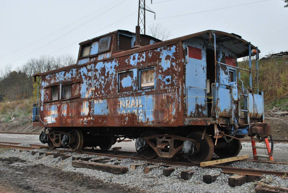

We first became aware of the car's availability at the end of summer 2011. We had amassed private donations to purchase the car from the private owner, but the owner reneged on the purchase agreement and sold the car to a scrap dealer. After we tracked down the scrap yard (previous owner would not tell us who he sold to), we made a deal with the scrap yard to purchase the car. This doubled the price, so more donations were solicited.
File comment: LV 95100 rescued from junk yard October 2011

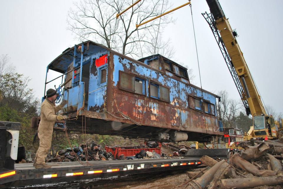

We rescued it from the scrap yard in October 2011, and moved it to the Rochester & Genesee Valley Railroad Museum by the end of that month. It is our goal to restore this car to its mid-1970s appearance, to pair with our preserved Lehigh Valley RS-3m 211. The car will be restored entirely through volunteer labor. We will be depending entirely on outside donations in order to complete the work.

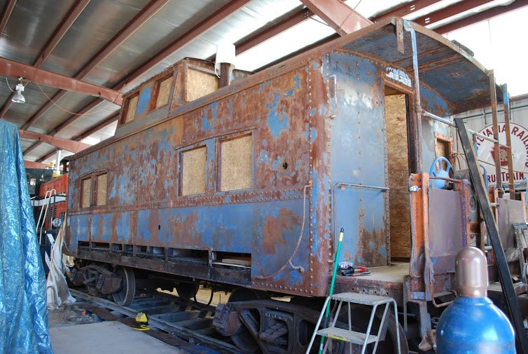

By the end of 2012, we had the exterior needle scaled and cleaned up, and removed any parts that would be in the way of repairs. We also began to clean and strip the wooden interior to facilitate the welding repairs we would have to make to the exterior.
File comment: LV 95100 - December 2012

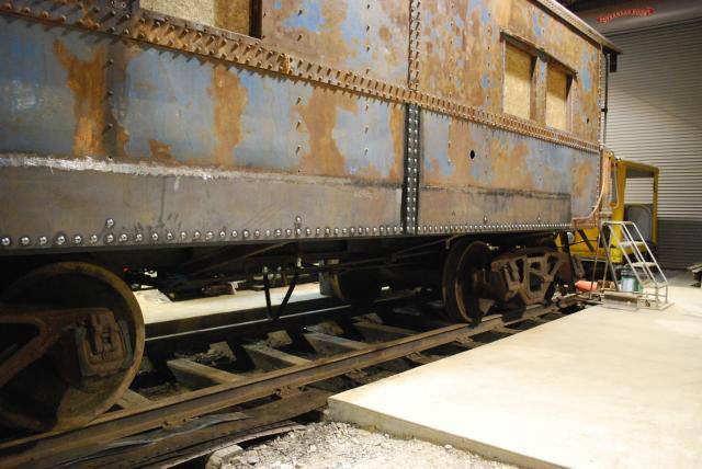

By the spring of 2013, we began replacing rotten sheet metal on the west side of LV 95100. We found evidence where a similar repair had been made years ago. Condensation gets trapped between the walls and eventually the bottom starts to rot out.
File comment: LV 95100 - April 2013
Each step of the restoration is being funded by private donations.

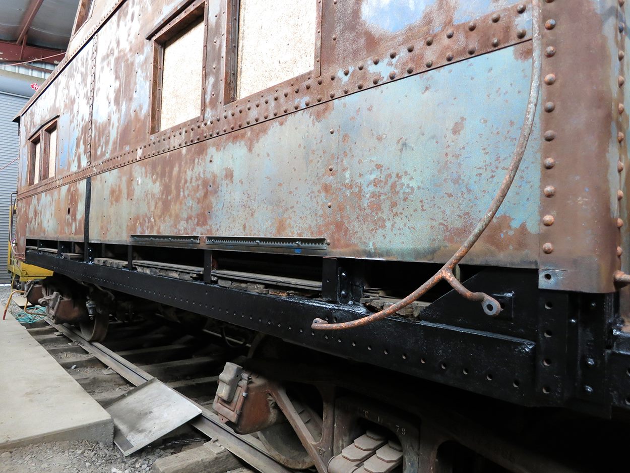

By June 2013, the east side had been prepped for metal replacement. The paint on both the body and steel will help to prevent the corrosion that led to the need to change out this steel for what be the third time on this caboose.

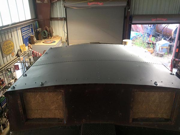

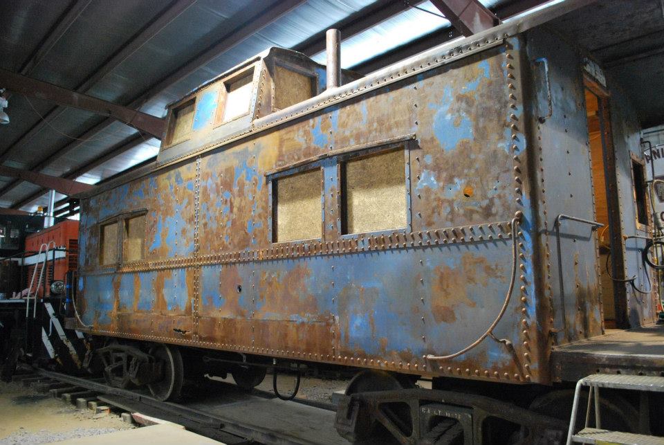

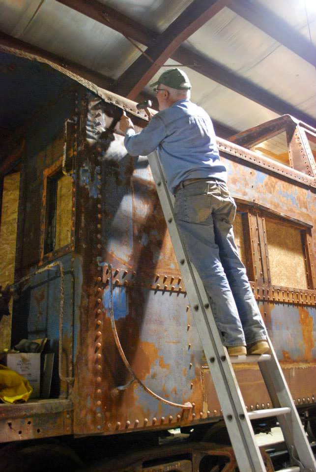

By September 2013, new metal had been installed and riveted on both sides of the Lehigh Valley caboose No. 95100.
File comment: LV 95100 - September 2013

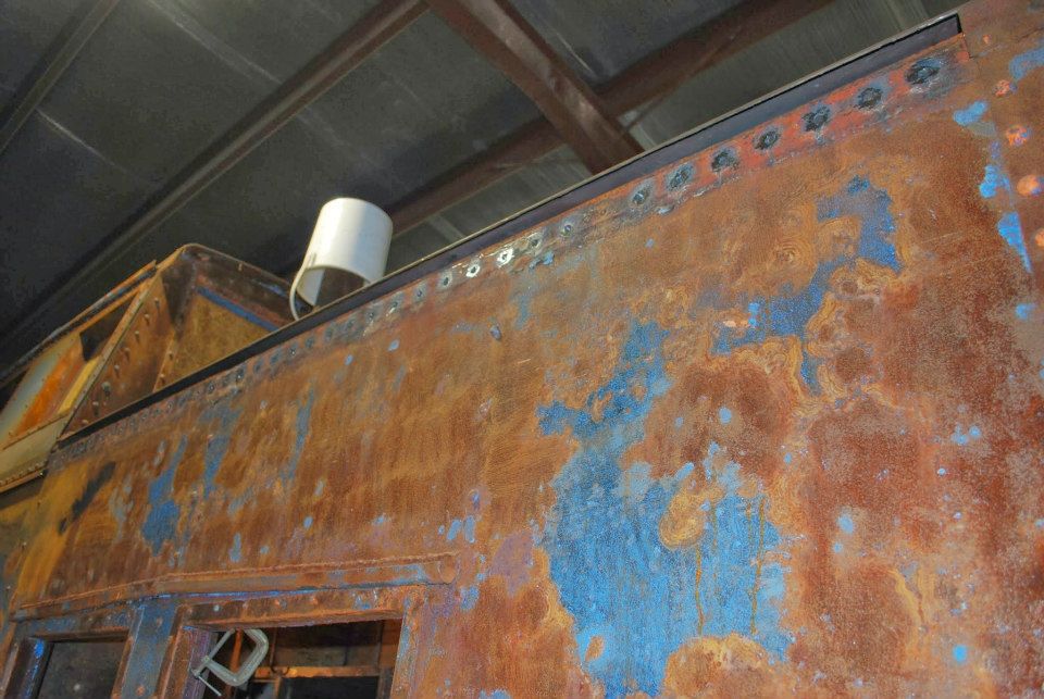

Next we turned our attention to some roofline repairs. These were addressed in November.
File comment: LV 95100 - November 2013

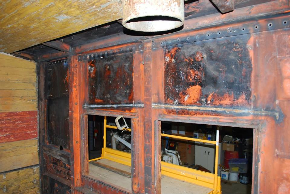

You can see what the repair looked like from the inside of the car. The wooden interior was dismantled and cataloged so it can be reinstalled when metal repairs are complete.
File comment: LV 95100 - November 2013, interior

Did you guys actually use rivets to secure the new side sheet repairs?
 Post subject: Re: Lehigh Valley 95100 at RGVRRM
PostPosted: Tue May 10, 2016 8:23 am
Joined: Wed Jun 03, 2009 9:39 pm
Posts: 77
Location: Rochester, NY

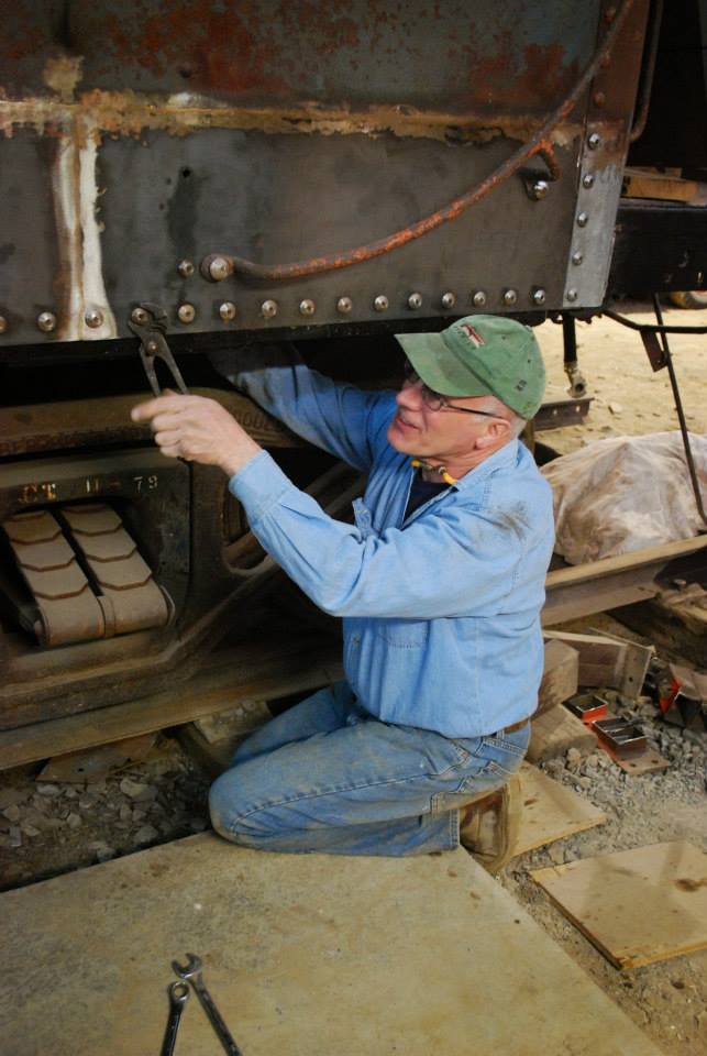

We used real rivets along the roof line. The rivets were heated with a torch and installed with a set of air hammers:
We used tension control bolts to fasten the lower sheets. These particular bolts resemble rivets when installed and are relatively easy to work with.
We ground off the raised lettering on the bolt heads to better simulate real rivets.
Link:
http://www.lejeunebolt.com/?q=products/ ... trol-bolts

We identified some areas along the roof line of LV 95110 that needed work. Additional steel repairs took place in May 2014.
File comment: LV 95100 - May 2014

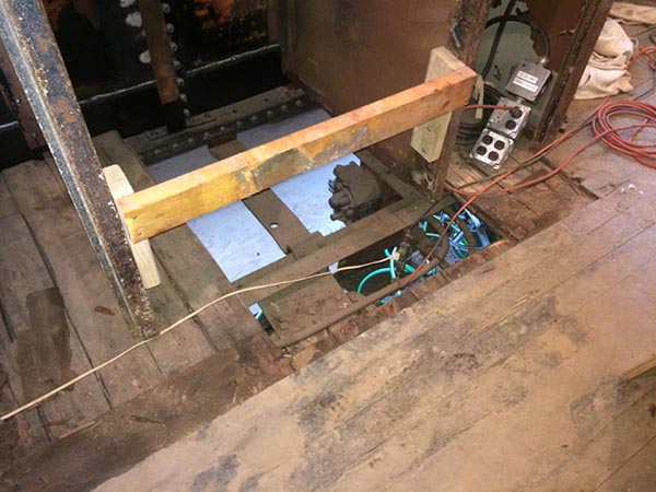

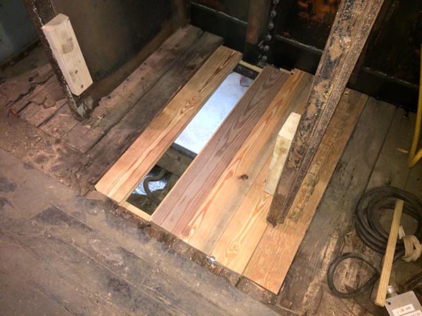

Work on LV 95100 continued through the winter of 2015 at Rochester & Genesee Valley Railroad Museum, shifting to the interior of the caboose. The floor had weakened and rotted away in two areas, and they were replaced.
The area under the icebox had completely rotted away. We pulled out the icebox to make repairs to it (the bottom had rotted from years of condensation), and also to replace the floor in this critical area. We found stencils on the metal walls that read "L.V.R.R. SAYRE."
File comment: LV 95100- January 2015
File comment: LV 95100 - icebox floor repair site
Our volunteers also replaced a section of floor in the southwest corner of the caboose that had been damaged.
File comment: LV 95100 - February 2015

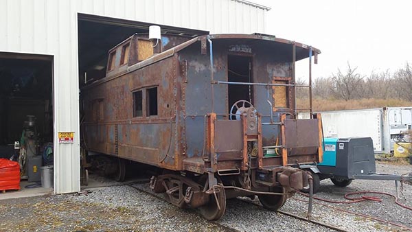

With exterior metal repairs completed on the Lehigh Valley caboose, we turned our attention to finishing in the fall of 2015.
The cupola roof was sandblasted and primed. You'll note the grab irons were torched off in the 1970s, as there was a strict rule against employees occupying the rooftop of any car. At some point in the future, we may replace these grab irons to complete the restoration.
File comment: LV 95100 - October 2015

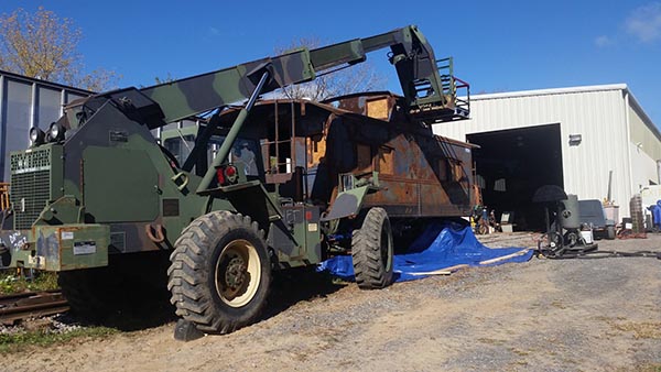

Thanks to a generous grant by the Thomas E. Dailey Foundation, we were able to fully fund the sandblasting and priming of the caboose exterior. We eased LV 95100 out the south end of our shop building to facilitate this work. This was the first time the car had been outdoors since its arrival in 2011.
File comment: LV 95100 - outside time
Our recently acquired Telehandler forklift equipped with a man cage helped access all areas of the caboose body to complete the sandblasting process by the end of October.
File comment: LV 95100 and RGV Telehandler sandblasting, October 2015

That rivet work looks impressive. Few restorations have the interest or knowledge to do actual riveting of side or roof sheets such as seen here. Most take the easy way out and just use bolts throughout. Good job.

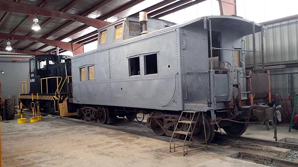

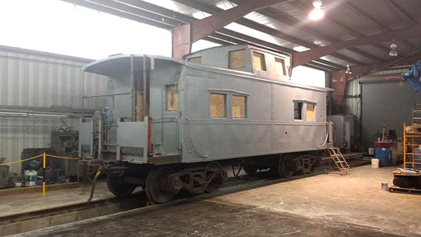

By the end of 2015, we had completed primer on the exterior of the caboose body. Next steps involve doing a little filler and body work before we apply an exterior finish later this summer. We have the exterior paint partially funded thanks to a generous $3000.00 grant from the Thomas E. Dailey Foundation. Your donations in any amount will help move progress forward.
File comment: LV 95100 - December 2015
Progress continues on the interior of Lehigh Valley 95100, with additional boards replaced and repairs to the base of the icebox completed. Work will continue through the spring and summer as time and resources allow.
