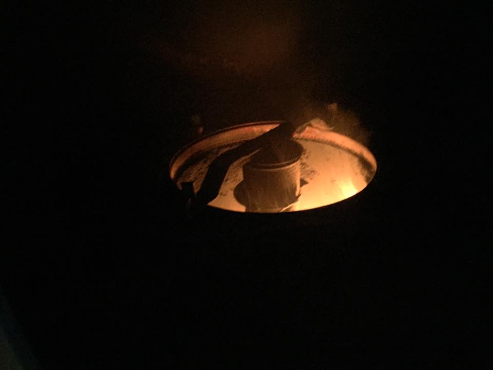

"Today we fired up 24029's San-O Cab Heater for the first time in years. Next is to bleed the fuel lines between the tank and the first valve before the stove and it will be ready for use. Thanks to Steve Huse and his brother for spending the day crawling around on the floor helping me with this."

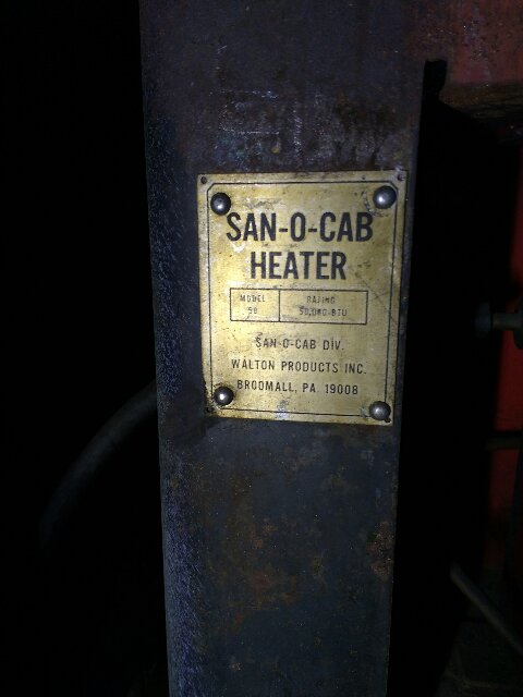

San-O-Cab Div Walton Products INC Broomall PA was the manufacturer. The only Walton Products company I see on the web has only been in business 25 years or so.
Here's the model serial tag.
Will try to post a picture of the stove tomorrow.

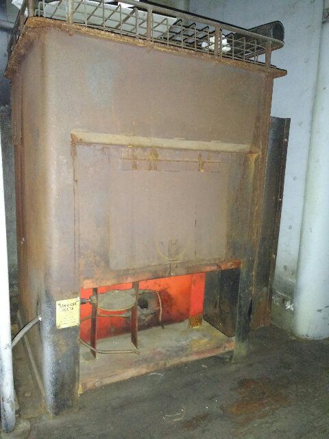

This is what I am working with.
