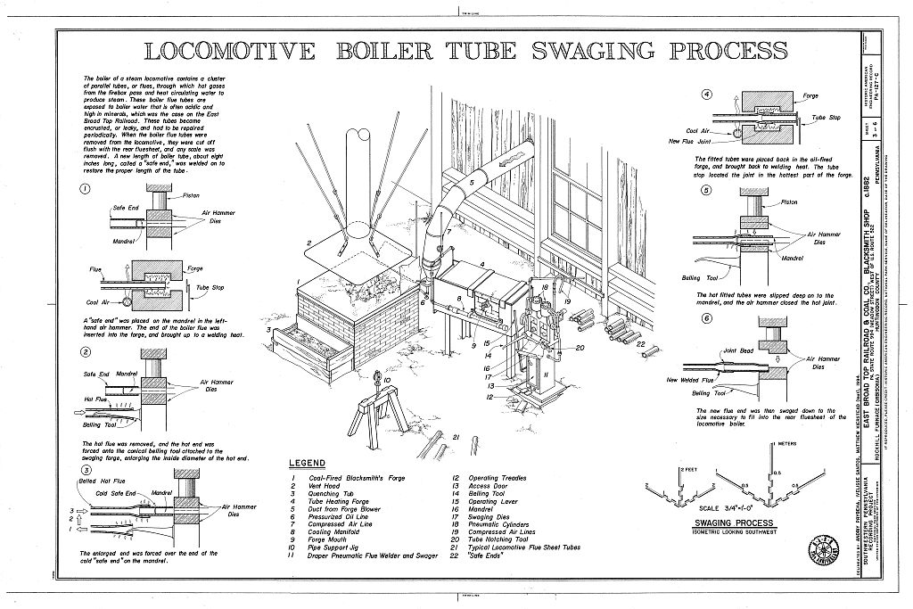

An HAER survey of the E. Broad Top RR shop included this graphic depiction of the swaging and forge weld process for safe ending serviceable boiler tubes for reuse.
https://www.loc.gov/resource/hhh.pa3372.sheet/?sp=3/
