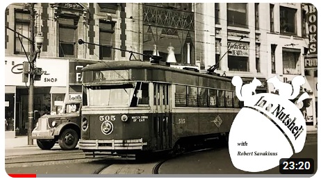

Sorry it's been so long since we've posted an update, I think we all know the past couple years have been difficult. We've got some big things on the horizon for 2023. Stay tuned.
Video link - - - - > https://www.youtube.com/watch?v=zggCoKo9-84

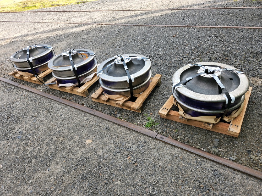

Thanks, Matt - we still have a long way to go, but I think we're going to scratch a lot more off the list in the next 12-24 months. Below is a photo of the offset wheels that we received from McKees Rocks at the end of the summer. Hopefully, our first pair of motors aren't far behind. Association members will tackle truck assembly as the carbody comes together.
