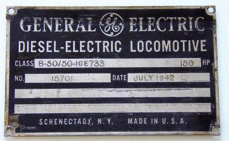

Ok, have the 2 new builders plates being done for our GE 25tonner. However, need some assistance with a few numbers. THe shop doing the plates is going to print the numbers right onto it, instead of us using the number punch. Will of course make it stand out more, and make it very readable.
Found this plate on line, ours will be similar, but my question is do the numbers on the CLASS line all match for any 25tonner? Ours is, as far as we know, original, except for a train brake being added. I just want to make sure the correct numbers go in that spot.
Any help is appreciated.

Would be similar or, the 733 is traction motor model number installed in the locomotive. You will need to climb underneath and check the data plate on your unit to verify.
The way the number system in the early switchers works is:
B-50/50-1GE733 =
--Axel Arrangement - B meaning 2 powered axles in the same mounting assembly (whole locomotive is considered a truck in your case, whereas a 44 tonner is BB-88/88 as it has 2 trucks both of which have 2 powered axles)
--Weight on axle groups in 1000 lbs - 50/50 thus 25 tons on either axle
--# of traction motors - 1
--model of traction motors - GE733
Never understood the weight part but that is how it was explained to me
25 tonners are 50/50
30 tonners are 60/60
44 tonners are 88/88
45 tonners are 90/90
Your serial # should be stamped near the striker plate in the engineer's door frame and on the front or rear frame member next to the coupler.
The two numbers represent the weight on drivers and the total weight in thousands of pounds. Not totally sure which is which.
Why the two numbers? Probably because some of the mainline straight electrics had un-powered lead axles or trucks. But, I have yet to see a plate from one of these.

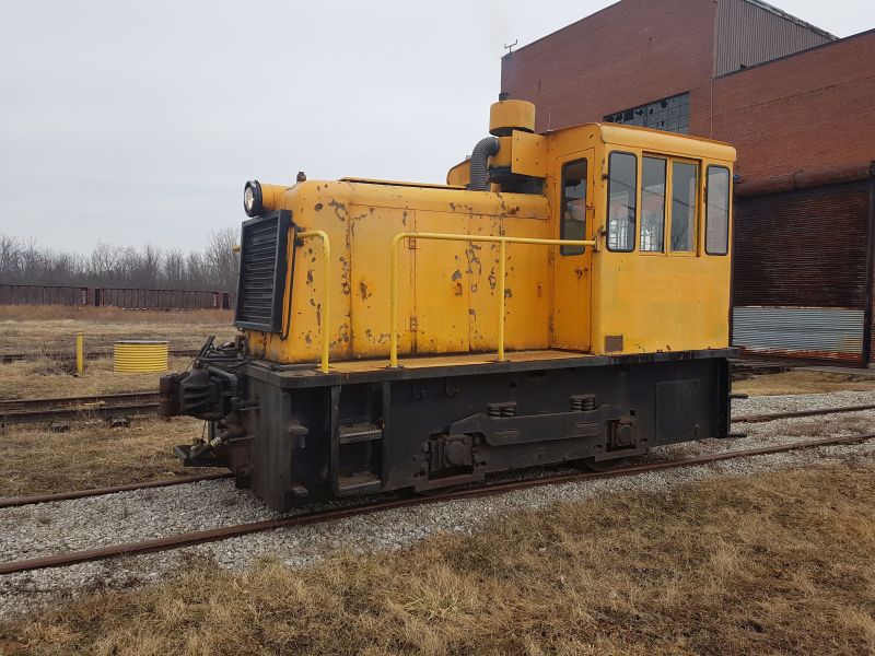

Bowmore wrote:
We have a 23 ton GE switcher. Can you tell me where the builder's plate is located? Thank you
Well, on ones i've seen, usually on the side of the cab. Ours are missing, but they obviously painted the engine before taking them off. In the pic, you can see where it was by the brown rectangle at the down left corner of the cab.

IIRC on our 25 tonner, the engineer's plate was also in the front corner, but I have a photo of one of her sisters where the fireman's plate is in the rear corner. Best to look for the 4 holes, they used drive screws in the 4 corners, so you will have holes between 1/8" to 3/16" diameter. If they have been filled they might be easier to see from the inside since there is usually only 1 layer of wall metal, and they probably didn't grind the interior smooth afterwards.

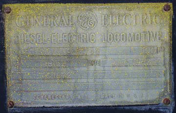

The plate on our 25 ton GE is mounted on the frame, under the fireman's side of the cab. It is possible that it was moved there, as we have photos of the locomotive after an accident laying on the fireman's side.
Our plate reads:
B-50/50 – 1GE 733 150HP
18139 Dec 1943
TG1872 21547
DN 153126
This locomotive came to us from the Nevada Test Site, where it was used on the "Jackass & Western" railroad, located on Area 25. The railroad was used as part of the Atomic Energy Commission (AEC) and NASA's project Rover, , later called Nerva, to build a nuclear powered rocket for travel to Mars...

As I mentioned in an earlier post, the yellow 25tonner is ours, and someone had mentioned to look for the holes. In our case, they are where the unpainted section is on the cab. John Redden, thanks for the rebuild info. We had the history of the unit, but not that part, good to know. I thought I saw somewhere online in one of my google searches for GE 25 tonner, the plate was in the middle bottom of the cab. Could be wrong though.
