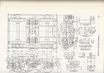

Folks, we're looking for a diagram or diagrams, of two axle Commonwealth tender trucks. We are beginning to prep 470's tender trucks for disassembly, and we'd prefer to go in with a road map, so to speak.

I found this in my 1930 locomotive cyclopedia, the truck diagram is the tender trucks used on the Central RR of New Jersey Tenders of their Pacifics.
The trucks are COMMONWEALTH TYPE.
I hope this helps, Pat WLS.
That illustration is for the Top equalized trucks - shown in Fig. 1900 on the next page. 470 has the Drop equalized type, as in 1930's Fig. 1899. I checked the 1922, 1919 and 1912 editions and there are no Commonwealth drop drawings in any of them. I don't have the '25 or '27 editions and don't find them readily online, there may be something in those.

Pat: I am unable to enlarge the drawing which came through in your message. It appears we're looking at a different style of truck. Thanks everybody who responded. Still looking for the correct model.

Posts: 283
Dick -
Strasburg 475 and OR&N197 both have Commonwealth drop equalized trucks like 470's. I'd contact Strasburg or the folks in Portland. 475 is in for it's 1472, so Kelly and his crew might have drawings out on the table already.
