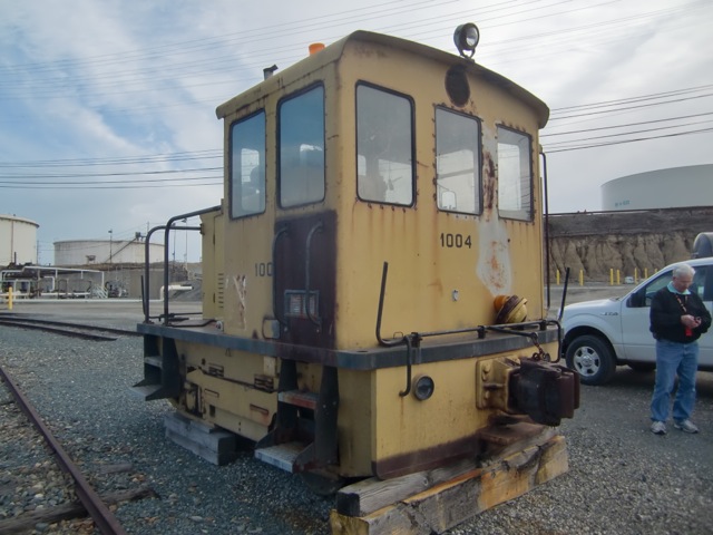

Our railroad society was just gifted this engine. I was fortunate to find someone who e-mailed me the manual for it. The bell housing is cracked and will be welded in January.
I would appreciate any advice to help with the restoration.
http://i1250.photobucket.com/albums/hh524/Talisker92/23%20Ton%20Switcher/IMG_5896_zpsedlha2pg.jpg

What railroad society? Located where? Where did the engine come from? (We don't know any of these things).
Clean it up good especially in the electrical locker, vacuum and a blow gun (gently used) are your friend there.
3 12v truck batteries, group 31 are plenty to start it, and you can start to find out what other problems it has. The voltage is a little higher but within tolerance. The onboard alternator/gen won't charge them so you'll need to charge them separately. That way you can avoid buying a couple thousand worth of batteries just to find out it has a major failure.
Be careful welding up the bellhousing, the alignment is critical and you don't want to change it.

Based on the information given it is probably this one:
15010 23T D/E B Std 150hp Cum HBI-600 11/11/1941
Tidewater Associated Oil #1004, Avon, Calif End cab
Phillips Oil #1004, Avon, Calif
Lion Oil #1004, Avon, Calif
Tosco #1004, Avon, Calif
Diamond-Shamrock #1004, Avon, Calif

Hard to know where to give advice before we know what else is going on. But one thing to do is remove the air cleaner to where you can get a flat surface, one you can cover with a flat piece of plywood, to completely choke the air off. ANY time you turn over a diesel it -could- start. If there is a major failure it could run away and the only way to kill a diesel doing that is to choke off the air, and you don't want to be trying to figure that out while it's winding away. Keep it that way till you are confidant you have control of the engine.
Of course change the filters and oil. Correct oil is whatever 15w40 diesel grade oil you like, Rotella, Delo, Napa fleet...

If I was going to bring this one back to life:
First pressure wash the engine compartment. Get rid of the dirt. In the electrical cabinet vacuum up all the cobwebs then spray down all the contactors etc. with electrical contact cleaner. Let the loco dry out. (In CA that shouldn't take long)
Disconnect the old batteries and instead wire up three car (or truck) batteries in series. We start a Davenport with an almost identical engine with two car batteries.
Change the oil. Change the oil filter. Change the fuel filter. Bleed the fuel line. Add diesel fuel to the tank.
Check the coolant? Is there any in it? If not water will work for the purposes of a test run. If it starts and runs then you can drain the water and put in real antifreeze.
Check oil level in air compressor.
Make sure you have a way to stop the engine. It should already be set up to work off of a shut off switch in the cab. But if it doesn't shut the engine down this is what to do. On those Cummins PT injector pumps there is a solenoid shut off valve above it (I can see it in one of your pics). There should be a knurled knob to the left of it. Turn it counterclockwise to stop the engine. Pegasuspinto is correct in that you should have a way to cut off air flow to the engine just in case.
Have an ABC or CO2 fire extinguisher handy.
Then push the button.
Don't forget to film it all, either for educational or entertainment purposes, depending on what happens when it starts!

OK, I see one oddball thing, it has a starter. Were not all these exciter cranked? I'm pretty sure this one never had a starter from the factory, because it has the correct amount of solenoids in the cabinet. But not the first time I've seen someone add a regular starter...
Also it looks like someone added straight brakes to it, tried to bypass the 14EL brake system?

This engine and other equipment was originally offered in 2015 to the Western Railway Museum.
Data below is courtesy of Mr. K. Wyatt from the Cal. State Ry Museum.
Here is info on the 23 ton GE loco.
#1004 GE 23 ton (1-A body style) c-n 15010, blt 11-1941
Blt for Tide Water Associated Oil Co #1004; Tidewater Oil Co #1004; Phillips Petroleum #1004; Lion Oil co #1004; Tosco #1004; Diamond Shamrock, Ultramar Div #1004. It ended it's life at the Tesoro Golden Eagle Refinery in Martinez, Ca. were it was stored out of service for many years.
Cheers
Karl Johnson
