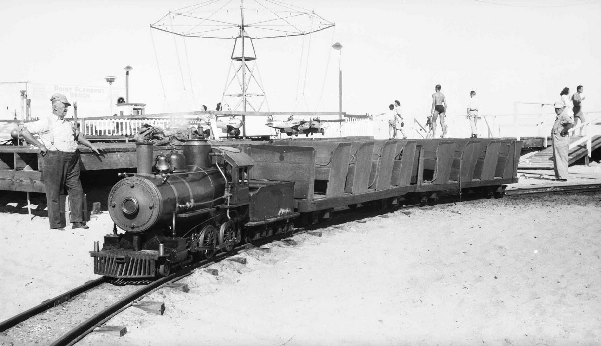

Bob Parr was a great old guy and a lot more than just a “watchman.” At the time of his passing he was building a 15” gauge Hudson!
That is Bob standing to the left of the 15” Cagney
Keith
File comment: Bob Parr at Point Pleasant Beach, NJ running a Cagney for Mrs. Lillian Cagney
