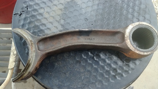

The Florida Railroad Museum is working on bringing our CF7 #204 back to life. After going through the engine, we found a bent connecting rod on #12 cylinder (photo attached). Looking for leads on who might have older EMD parts. The #204 has has a B-block converted by Santa Fe to a BC block. The connecting rods are of the older b-block style that wrap around the wrist pin (again photo attached). Part number on rod that came out is 8159013
Any leads for a supplier would be appreciated.

I would try Hatch & Kirk. We used them alot for our old 567 power but its been a few years now since we used them but worth a try. They used to be the " go to place" for our small fleet of 567 power.

Hatch & Kirk would be my go-to as well.
They were/are the OEM for quite a bit of EMD stuff, but I know they have been thinning the older stuff out lately. Still worth a call though.

Question from a non-technical railfan. How could only one connecting rod be so bent and the others be OK?

Probably from not blowing down the cylinders of any water before trying to start, especially if it sat for awhile.

That cylinder could have hydrolocked or seized.
15 or 20 years ago we almost lost a F-unit to such a incident, for some reason it wasn't blown out properly before starting and one cylinder had some water in it. In our case the connecting rod broke and punched straight down, it did not damage the block but did damage the oil pan, which fortunately was able to be repaired without removing the engine from the locomotive.
The damaged power assembly was replaced, and that locomotive has operated ever since.

No doubt blowing them down is key. We blow down our other EMD's every time, the 204 came to us this way. Oddly enough we could not find a leak on the cylinder. Nothing in the exhaust port, head nor liner. Thinking it had rain water in it, they (kinder Morgan) rolled it over and there goes the rod. Once we get it back together we will continue to check it for a leak(s).
Thanks for the lead on Hatch & Kirk, they list the 567B rods on their site, I already requested a quote.
