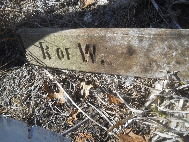

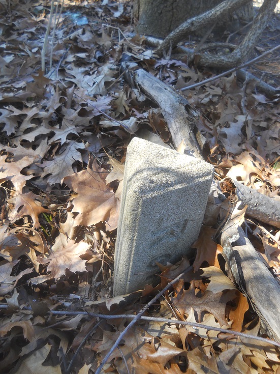

Discovered last Saturday. Shovel and some sweat today. Help from Shad and Bing. Future display.

This old concrete C&O right-of-way post was located at the Hoosier Valley Railroad Museum site but buried in the trees that have grown up.

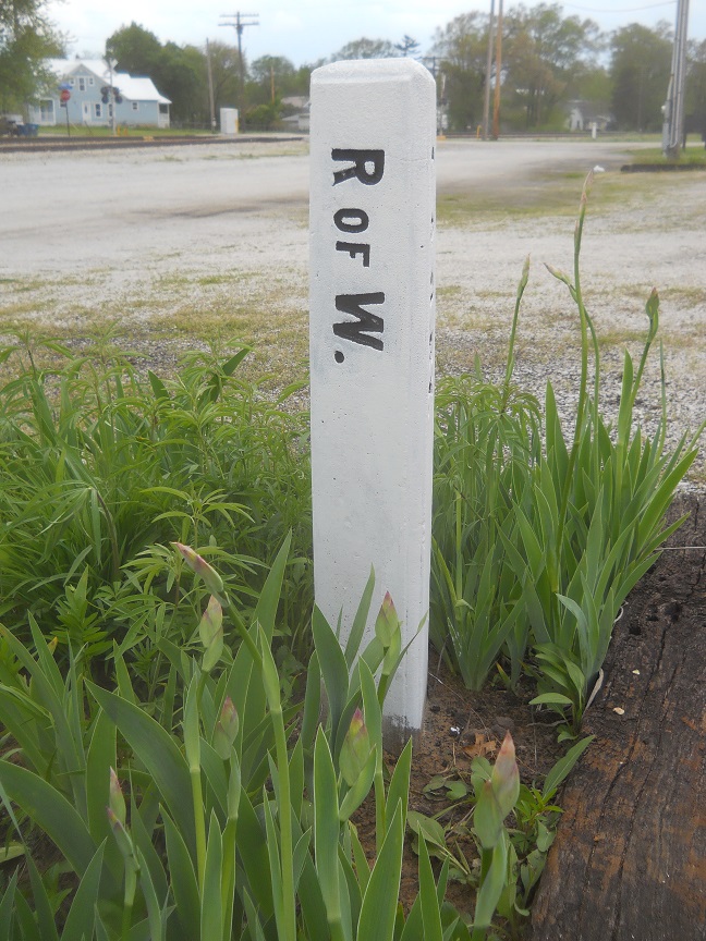

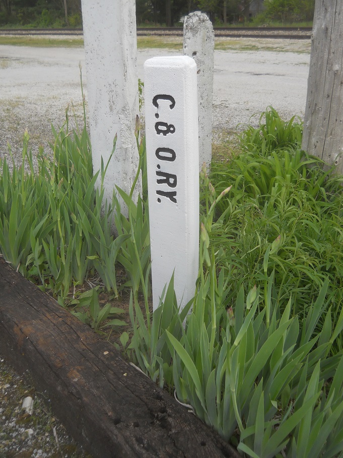

Original subject of this thread now on display at museum after painting today.
