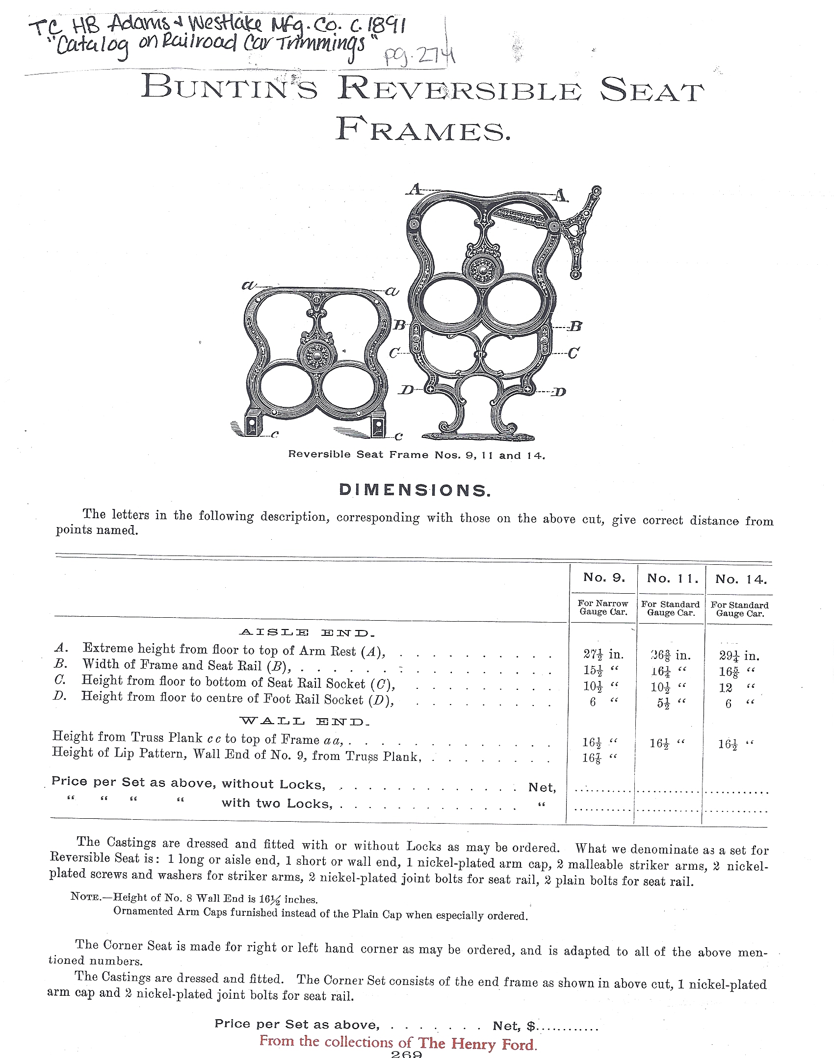

The SPCRR (Fremont California) has the patterns for an earlier Buntin seat. This was a common seat used on 1870-1880 narrow gauge cars. Castings from these patterns are being used on one of the C&TS historic cars. The casting set consists of a seat end, a wall end, two arms (to support the back) an arm rest and a couple of small brackets.
File comment: Buntin seat end

Buntin seat pics similar to what Randy posted above, for those interested, but with folding backs and headrests. https://delaware.contentdm.oclc.org/dig ... 25/rec/808
