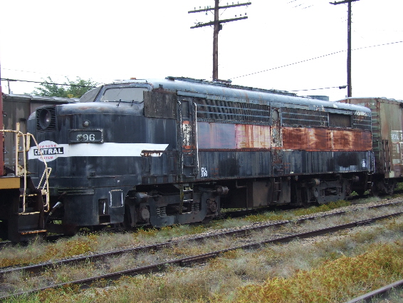

Is this one still at the Delaware-Lackawanna shops in Scranton (DL #596)?
It was looking a bit sorry for itself back in September 2011, but I found a photo online from a couple of years ago that indicated some restoration work had been done on it.
Additionally, VIA #6763, shown in the posted list (2010 dated) at Danbury had obviously gravitated to Scranton by Sept 2011.
