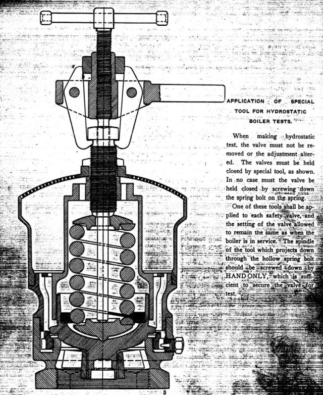

Does anyone have a photo or drawing that would show a different angle of this tool used by the Pennsylvania RR for locomotives with Coale safety valves?

Such devices are often called a "gag", as in "safety valve testing gag".
A quick search for "safety valve gag" returned several hits, including Patent 1290520, assigned in 1919 to Ashcroft, shows a safety valve gag invention. It can be found by searching for that patent number at your favorite patent site, or, for example, at https://patents.google.com/patent/US1290520A/en . Follow the link for the PDF file which shows a diagram of the invention.
In principle, the "gag" applies downward pressure on a "spindle", and is retained by "jaws" which grab the underside of a nut or ring which is a native part of the safety valve.
The downward pressure is applied via a threaded rod in such a way as to force the far-end of the "jaws" apart, so that the retaining end of the "jaws" is forced positively against the sides of the nut or ring, guaranteeing that the "finger" on the jaw end stays under the nut or ring. This is a "feature" that is needed, so that the gag does not fly away when undergoing the hydro.
While I have not seen a PRR gag, and haven't seen any safety valve gag in the last 20 years or so, I would expect in your PRR drawing that the horizontal rod at the pivot-points of the jaws is there for convenient handling while installing and removing the gag, and is nothing more than a rod. I would expect that the perpendicular view would not expose any new features.
The VERY FIRST RULE when using a safety valve testing gag is to BE SURE TO REMOVE THE GAG AFTER THE TEST BUT BEFORE THE PRESSURE VESSEL IS PUT INTO SERVICE!

Thanks the responses and the correct name. The drawing gives almost enough detail to make one but I was curious what it looked like from the side.
