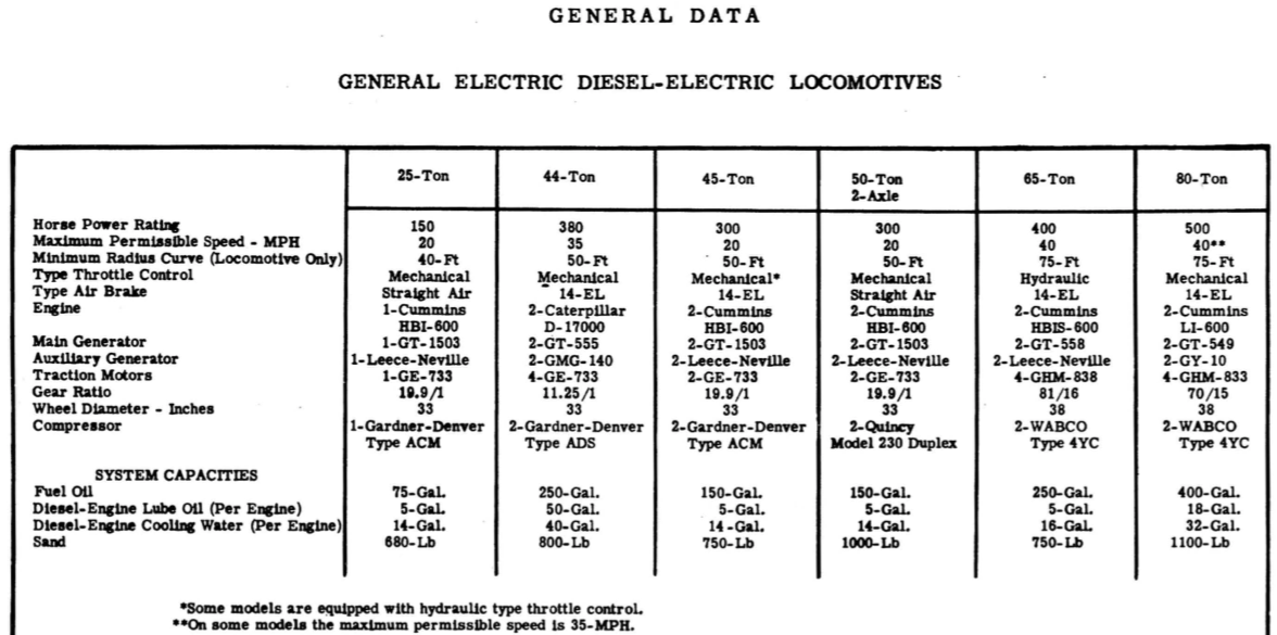

What is the geared speed for GE 65-tonner? TIA

According to a Navy manual max permisable speed is 42 mph

Thanks for the maintenance manual scans. 40 mph may be a problem for light engine move on Class One road mainline which is why I asked.
