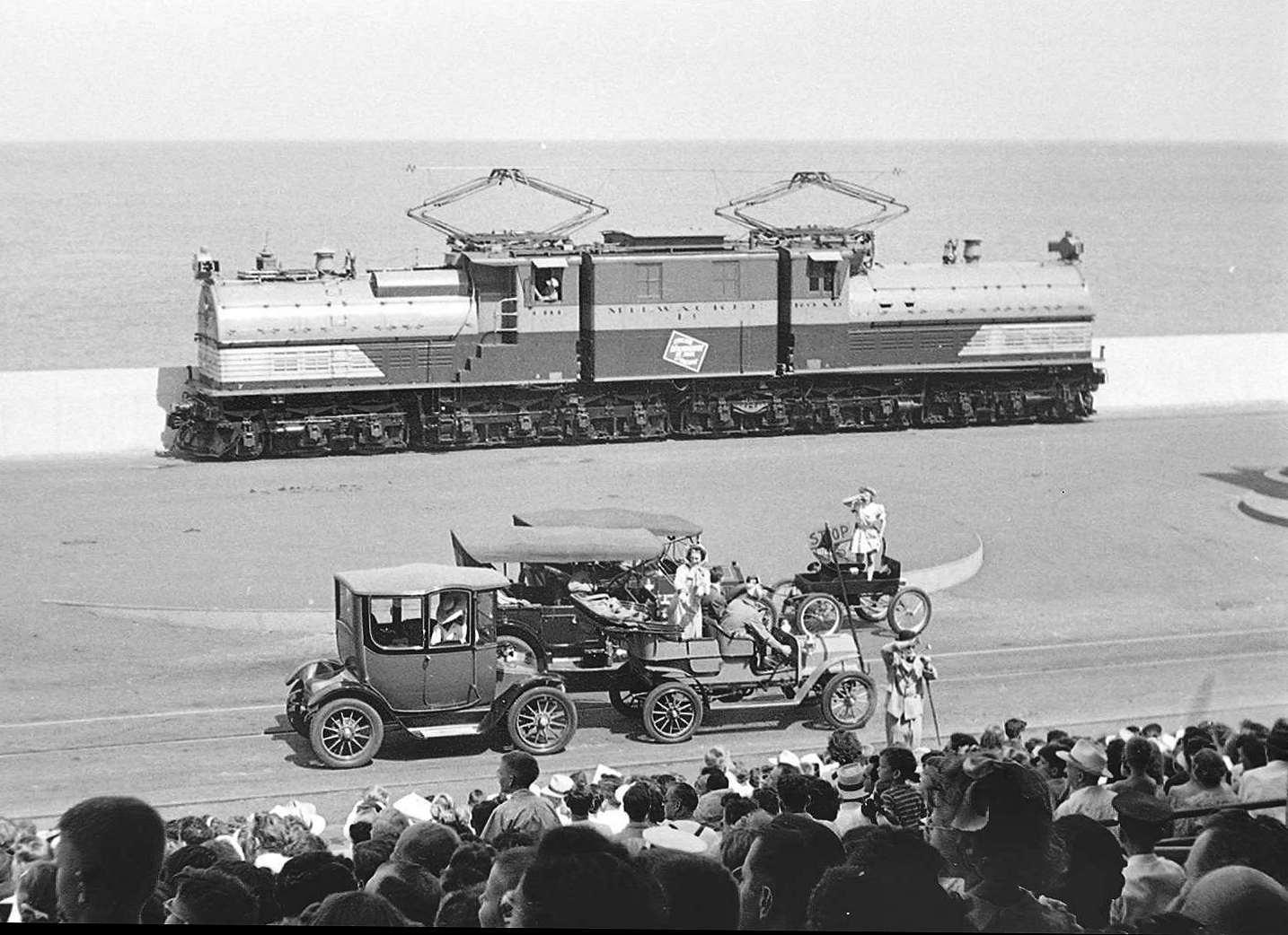

Somewhat off topic, but a friend gave me this photo of a Milwaukee Bipolar operating at the 1949 Chicago Railroad Fair. It has been a mystery to me how it was powered. It looks like there is a metal pole stretched over the pantograph shoes to simulate the overhead wire. But if that's the case, how was power delivered to that device? Was there a generator or battery hidden somewhere in the locomotive body? Or was the power delivered to the motors in some other manner? I would be interested in your comments.
I know this is an old thread but I have often found answers to my questions in older posts.
According to this site, https://www.rgusrail.com/ilcrf.html it was powered by hidden storage batteries.
