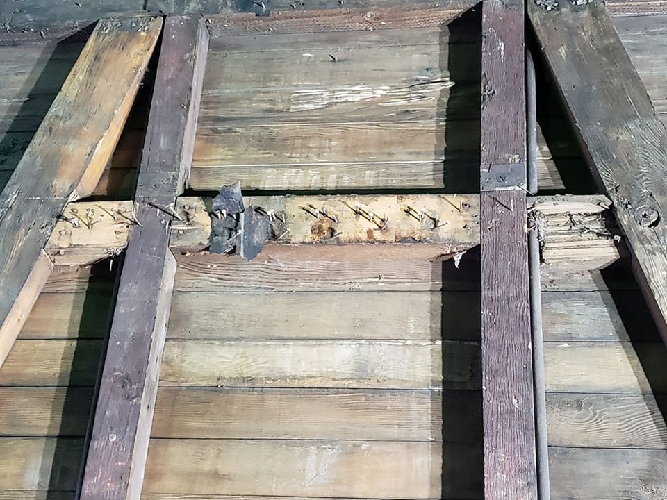

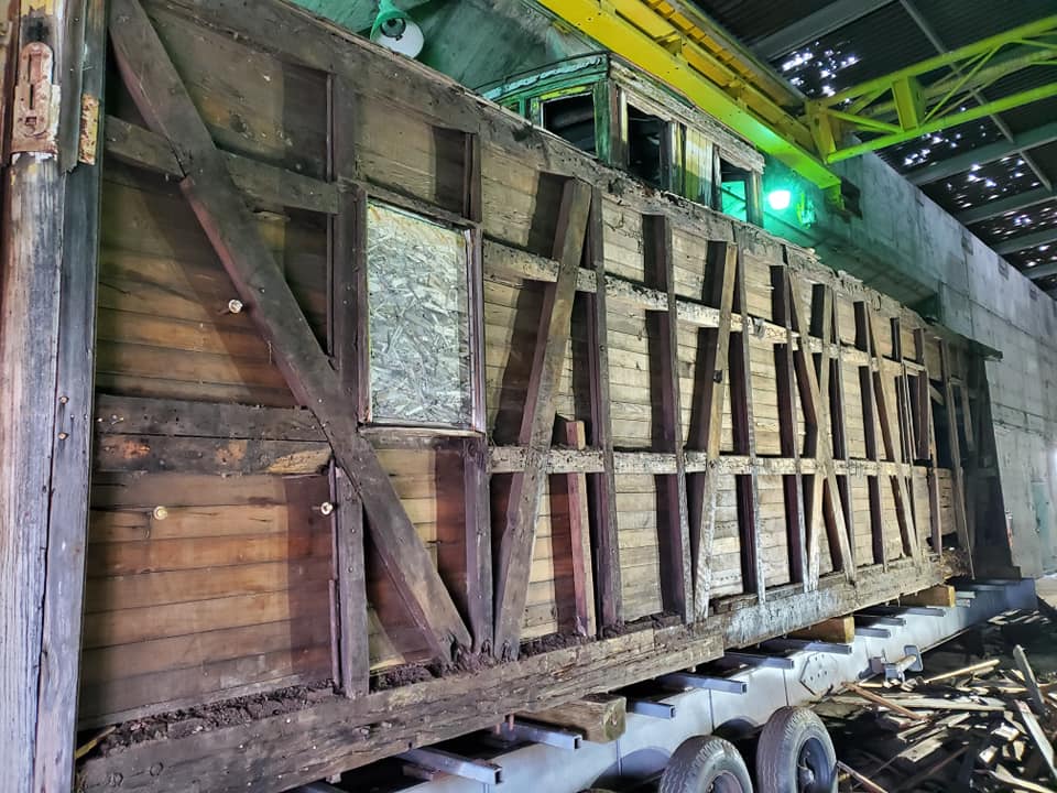

Today in Cheyenne on removal of the siding on our 1880 UP caboose 2095, we uncovered what we believe to be evidence of its former existence as 1150 a six window caboose with octagonal cupola from 1870, this has been shown to noted historians who so far agree with my detective work. 2095 was renumbered in 1885 from UP 1150 and has a build date of 1880, we believe that to be a RE build date from the earlier design. There is clear evidence of additional diagonal framing to the bodyside and oak uprights framing the 3 blocked up windows. cut off retaining strips above each window also add evidence. there are no plans or dating records for these cabooses except that photos show them from 1870 onwards until the NCS cabooses appear in 1880 with square narrow cupolas. Seems common sense to us that you would rebuild 10 year old cabooses rather than build new.

Is any of the roof original, and if so, can you see the outline of the octagonal cupola?

Retaining strips are pieces of wood that ran across the top inside the window and allowed the window to lift up parallel with the body, thats what the two screws are holding in but the middle of the wood has been cut out.
