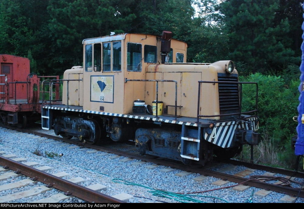

Hello all,
I have had no luck in finding a set of wiring diagrams for a 1947 45ton GE locomotive. I am helping the South Carolina Railroad Museum restore the engine. One of the major steps will be a complete rewire. I know I could run one wire at a time, but that gets difficult and there have been some, err, modifications over the years.
Does anyone know of a manual in PDF format with the schematics? Or a museum/library that might have one? I tried the Ft Eustis museum (loco is ex-Navy) but they didn't have the right manual. Google has also come up short, and my Googlefu is strong.
Any help would be greatly appriciated!
