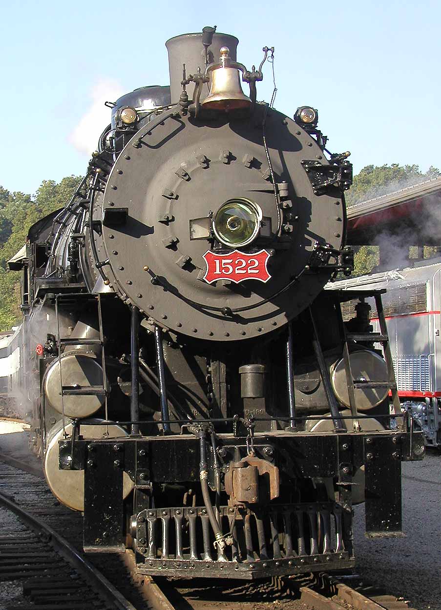

Kelly, that's exactly what I used. Never measured quantities. Mixed it in a coffee can. I used a parts washer wand with a pickup hose on it. Made a great graphite sprayer and you could control the spray. I had someone walk around with me holding the can and keeping the graphite in suspension while I sprayed.
Made very short work of the firebox with all those staybolt sleeves. That used to be a mess to do with brushes.
I wasn't there when the very first application was put on back in 88, but told the guys to use vertical strokes with the brush. They didn't.
I always liked the way the last method looked. It was bulletproof after the engine was fired up. I tried linseed oil early on and it really smelled bad so I decided mineral spirits was better along with steam oil.

Kelly Anderson wrote:
Here is ours, straight from the engine house supply cabinet door.
Kelly,
Curiosity killed the cat.... How often do you have to apply it? And do you mind if I add that to my color data file?

Posts: 1326
Location: Pacific, MO
I'm not Kelly, but you don't have to apply it that often. If you started out with a good sound surface it lasted a good while.
The photo of 1522 was taken right after our two farewell trips to Newburg and back and looks like it was just put on right before the picture.
