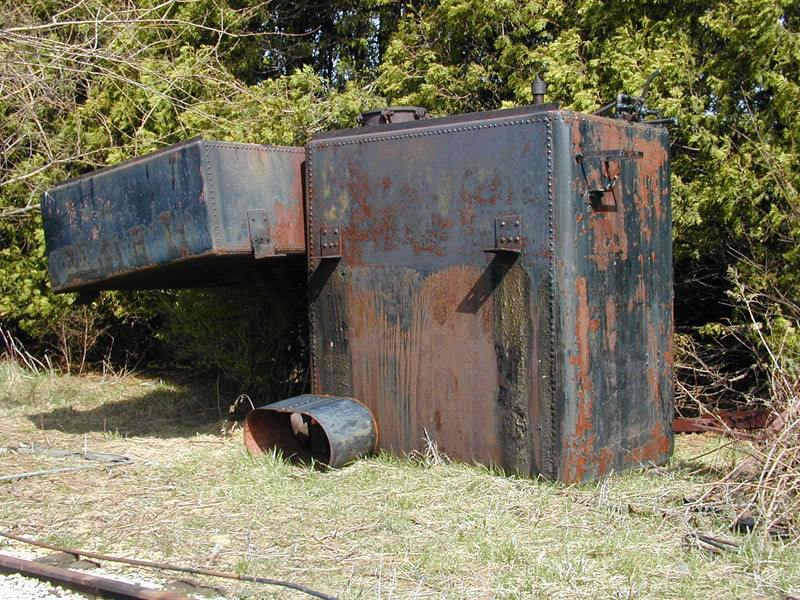

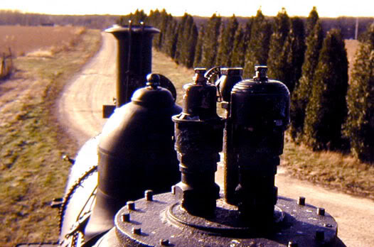

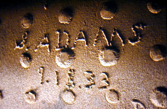

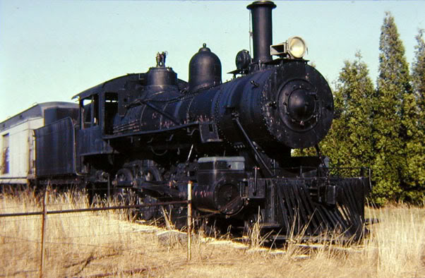

A few photos I took over the years at the winery location.
In 1933 Mr. Adams welded his signature inside the firebox of what by then was a very old locomotive. The were was no firepan and I think I placed the camera (shooting slides) on the axle and utilizing just the light bouncing up from the track held the shutter open a random amount of time which obviously worked.
The oil tank was left behind when the engine was shipped to Georgia. Part sat atop the back of the tender.
