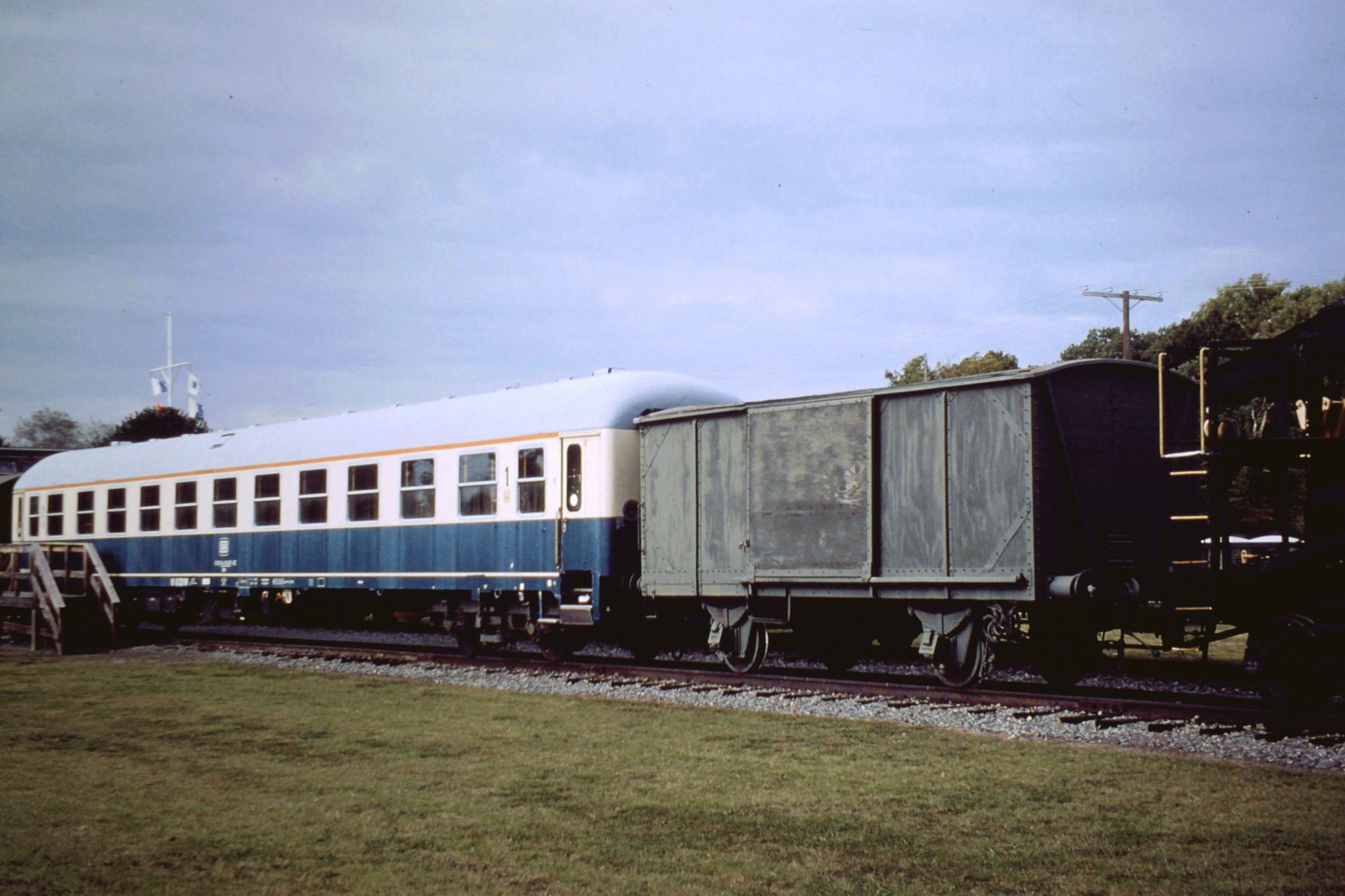

One of the 4-wheel boxcars was on display at the Fort Eustis Transportation Museum when I visited there in 1998 (along with a DB coach).
I assume it's still there?

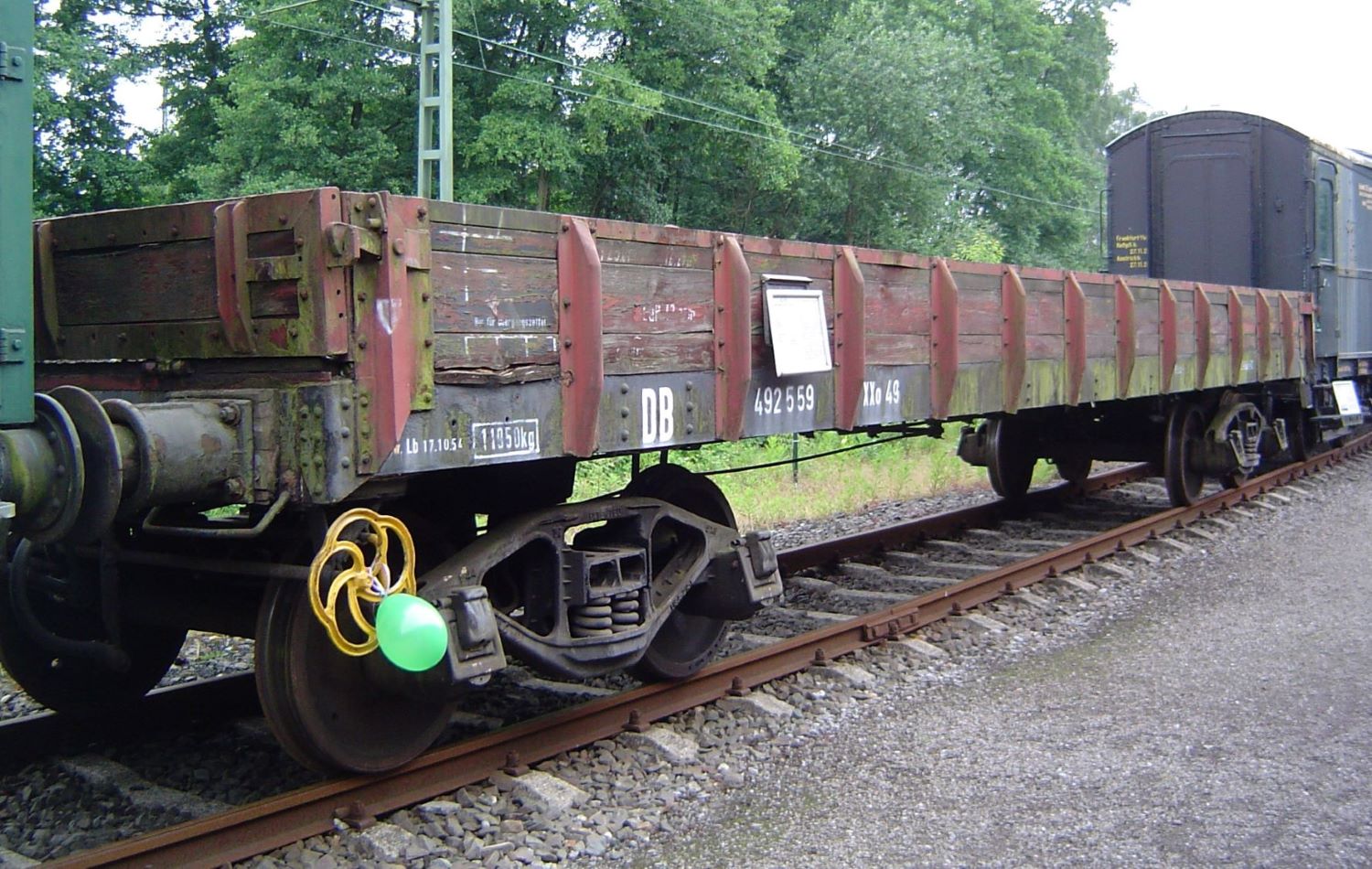

Not many of the USATC cars have survived in Europe, as most had fairly short working lives. There is certainly a flatcar, at least, at one of the German museums that I have visited, plus I have seen photos from a French museum which has a few different types in their collection.
EDIT -The German one I was thinking of is at the Bochum Dahlhausen museum and is actually a Gondola car

The DB car at the Transportation Museum isn't what most think it is. First, some history...
In the aftermath of WW II the US Army began running Berlin Duty Train in and out of West Berlin, located within East Germany. The trains ran at night and consisted of sleeper cars, plus one crew car on the south or west end of the train, depending upon where it was along the route between Frankfurt am Main in West Germany and the suburban Berlin-Lichterfeld-West Station in West Berlin, where the Army maintained an RTO (Railway Transportation Office) in a small building. The train headed north when departing Frankfurt but, entering East Germany at the border with Helmstedt on the west side and Marienborn on the east, the train was heading east. About half of the crew car consisted of compartments with seats and the other half was baggage space with a large baggage door.
There were several types of sleeper cars used on the train, with two to four compartments in each room. The least comfortable were the cars with ten compartments and six bunks. (The lowest two on each side were fixed in the flat, horizontal position as seats while the other four lay flat against the walls until they were turned to the horizontal position for use as bunks.) These less-desirable cars were used for such things as combat unit moves, such as an Army unit coming up to Berlin to go through the Combat in Cities course (never went there myself but I believe it consisted of mock-ups for training in urban combat) or Berlin Brigade units heading down to West Germany for training at one of the maneuver areas. Soldiers kept their rifles with them but such things are mortar base plates went into the baggage space of the crew car.
The length of the Berlin Duty Train between Frankfurt and West Berlin depended upon how many reservations were made ahead of time. If I recall correctly, a train might have as few as four cars or as many as eight, and possibly more.
There was also a Berlin Duty Train running between West Berlin and the port city of Bremerhaven. That train consistently had two sleeper cars. Bremerhaven was where POVs (personally owned vehicles) belonging to personnel stationed in Germany would go in or out of the country as personnel rotated from one assignment to the next.
Additionally, there was a "train" between Frankfurt and Bremerhaven. After the train to Berlin left around 8 p.m., a German train, with two US Army sleepers tacked on, departed Frankfurt at 10:38 p.m. and headed north. During the night it would be handed off to another train and then, in Hanover, it would be picked up by the Berlin-to-Bremerhaven train to be taken the rest of the way to its destination. On the way out, the Bremerhaven-to-Berlin train would carry two sleeping cars bound for Frankfurt as far as Braunschweig, where they were set off for the Berlin-Frankfurt train, which arrived right after the Berlin-bound train departed.
In addition to the three types of cars used, the Berlin-Frankfurt trains received some new sleeper cars in 1976 that included a comfortable lounge area.
There were no dining cars on the trains, and running them at night allowed the Army to skip meal services on board; however, not long after departing from the point of origin, a "Schaffner" would push a cart through the train to sell snacks and non-alcoholic drinks.
Other than the new cars that arrived in 1976, the cars in use were fairly old but well maintained.
I was on the trains as a conductor (more of a car host -- a Bundesbahn fellow was the true conductor in the West and, running over East German rails, we had a Reichsbahn conductor aboard) from late 1975 until early 1977.
It was many years later that the Army was getting some new cars for the trains when, due to the Cold War coming to an end, the Berlin Duty Trains stopped running in December 1990. The new cars were already in the pipeline but now there was no need for them. What to do with them? I'm told the car at the Fort Eustis museum was one of these cars intended for the Berlin Duty Train but never actually used on it, and instead it was shipped to the US for display.
Curiously, I see it has DB on it. The cars in the 1970s were built to European standards and were apparently constructed over there, and they were marked UNITED STATES ARMY on the sides. Perhaps to lower the profile and not tempt attacks from such groups as the Baader-Meinhof Gang, DB markings were put on the new cars.
At Fort Eustis there was also a European-style caboose on display with the DB car. The sign describing the caboose stated it was used as a crew car for the Berlin Duty Train, but this is not true. These were several cabooses and they were used as guard cars for MPs from the Berlin Brigade's 287th MP Company, as well as a radioman and an officer (train commander). These cars escorted freight trains run as needed between West Berlin and West Germany. For example, if the Berlin Brigade's tank company (Company F, 40th Armor) needed to go to a gunnery range in West Germany, the Rail Section MPs of the 287th escorted the train (tanks aboard flat cars) through East Germany. Since these trains had no passengers, there was no need for a conductor/car host, so I never stepped foot on any of the cabooses. I saw them only on rare occasions when, in the middle of a night, we might be paused in an East German railway yard and we happened to be right next to one of these Army freight trains. Unlike ours carrying passengers, those trains ran as extras and could spend a lot of time waiting at one location or another.
And now you know.
