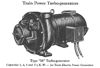

I am looking for information on the Pyle type "M" turbo generator.
Thanks
Tim

Dave wrote:
What do you want to know?
I am looking for pictures from the sides and the top. A detailed picturs of the lettering and tags.
Thanks
Tim
 Post subject: Re: Pyle Type "M" Generator Information
PostPosted: Fri Oct 09, 2020 3:35 pm
OK, will check my stacks of stuff. I know I have some technical stuff, not sure about artwork.

No artwork on the type M, closest I have is MO6. Sorry. Maybe somebody out there is using one and can take pictures for you.
Dave
PostPosted: Sat Oct 10, 2020 5:24 pm
Joined: Thu Aug 26, 2004 5:54 pm
Posts: 67
Dave
Thank you for looking.
Tim
