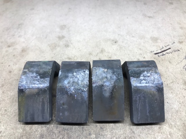

Has anyone ever seen this before? These contact tips have an odd problem.

This is an arcing issue that is caused by the contactors not touching the drum (the other side of what ever they touch if not a drum). It means they are not installed tight or the holders or spring tensioners are not tight. Essentially they are allowing small lighting bolts to be created between the contactors and the drum (arcing). It may also mean that the other side (the drum) is dirty, or clogged and or has some other issue that it is not conducting the electricity the correct way. Generally, this issue is simply poor contact and or not tight enough contact.

Agree, electrical arcing is "eroding" the material each time the contacts are disengaged. Most likely cause is loss of strength in the springs (metal springs do loose strength over decades of repeated cycles). You need good strong springs to "snap" the contacts out of engagement as quickly as possible. Could be fixed by replacing the springs and resurfacing the contacts. Other possible cause is poor (or slipped) adjustment of the contactor mechanism.
Weak springs could also allow the "tips" to bounce along the surface of the mating contact surface, thus allowing arcs to erode the "tips". This usually looks like "fuzzy" contact surfaces with small fine pits. Your photos look like "great big craters" that are more likely from arcs when breaking the electrical connection.
Need to resurface/replace the "tips" and the mating conductor surfaces and check adjustment/action of the mechanism. Operate the mechanism under power (with safety glasses) and see if there is arcing all the time when the tips are in contact, or big arcs only when the tips are "removed" from contact. That will give you a clue to the root cause of the problem.
One other possible cause is the failure of "arc suppression" devices; capacitors, snubbers, diodes, varistors etc. These are used in some systems to suppress arcing. Most high voltage capacitors do have a limited lifetime, if any are in the circuit I would look at them carefully as a suspect.

I saw this on a GP9 and when i went to the parts room there was a box of tips that looked like this, the owner said they have needed to be changed on a yearly basis, which I have never heard of. I performed a sequence check on the locomotive and found the power contactors opened every time the throttle was closed. Not proper, they should only open when the reverser is operated. I found a pair of wires on the isolation switch that had been reversed when the switch was changed, corrected the wires and now the same set of tips has lasted more then 10 years.

On most DC main generator locomotives of the 1940s and 1950s, there will be a large resistor wired in parallel with the main generator battery field. On the SW9, this is usually a 4-Ohm resistor.
It is very important that this resistor and its wiring should be in good condition, and that the resistor has continuity in the circuit. When the BF contactor is opened, the resistor dissipates the residual voltage in the battery field windings. If the resistor is open or not connected, there will be a high voltage spike leading to severe problems with arcing of the contacts.

Does the locomotive make transition and is it sequencing properly when the PTR picks up. Also as Preston says the field decay resistors are very important especially when the unit is in parrallel and the throttle is closed and backwards transition takes place.
Also the governor overriding solenoid is in play during transition and wheel slip to drive the load regulator to minimum field to drop the load.
