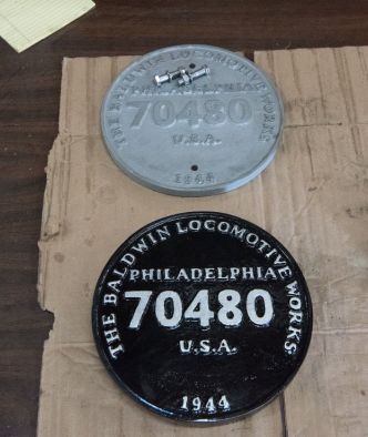

Some determination and creativity resulted in a replacement builder's plate for Alaska Railroad 557. One of our group used a 3D printer to create a pattern for our long missing plate using photos from a sister locomotive in the U.K. for an example. Software was Freecad and it was printed in four pieces and then glued together due to the 9" diameter being too large to print in one piece on his FDM printer. It was cast in iron as was the original - cast during an annual demonstration of a small iron cupola by a local art group. One challenge was that software doesn't support putting pattern draft on the edges of the letters. The solution was to make an RTV mould and use the lost wax process for the casting. Total cost to the organization - $0.00.
