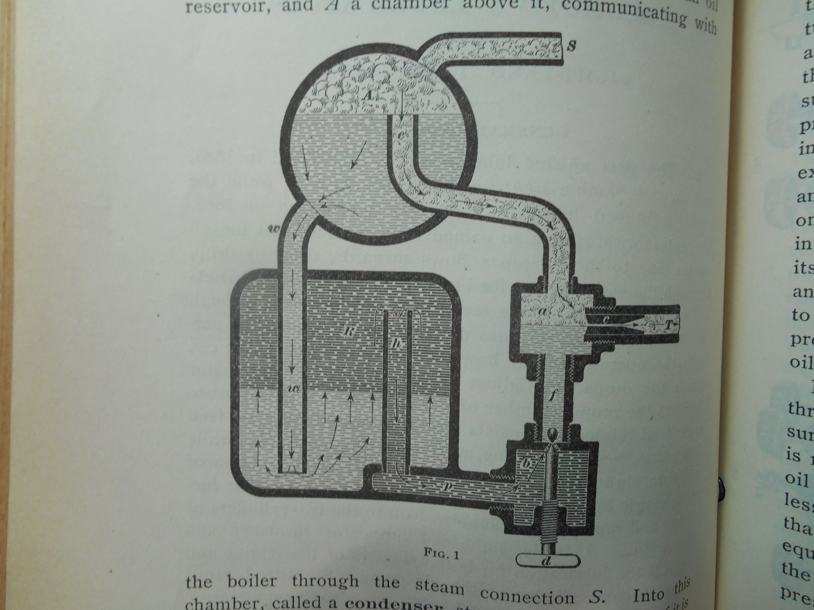

here is a drawing for a hydrostatic I swiped from an 1920 ICS book. This drawing shows how the water and oil intermix.
Robby Peartree
