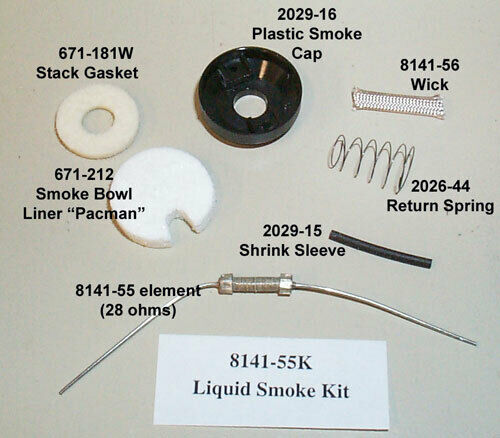

Posts: 734
Maybe a few of these?

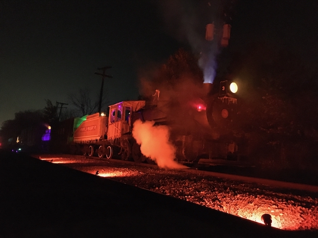

We did pretty much what you're looking to do with our 0-6-0 at Greenfield Village for our Halloween event last year and are gearing up to do it again this year. I did some experimenting as I set things up and figured out a couple of things.
First off, we simply used a fairly inexpensive fog machine placed on the bottom of the smokebox aimed towards the tube sheet (the baffle panels aren't currently installed in the smokebox). A wood block aimed it slightly upwards towards the stack opening but isn't totally necessary. The machine is connected to one of the fog machine timer boxes (wires extended and fed through one of the boiler tubes for easy adjustment in the cab) that can be turned on and left on. It has controls for fog duration as well as intervals which can be set based on how much fluid you prefer to go through in an evening. Once you build up a fog cloud in the smokebox it acts as sort of a reservoir and generally wafts out of the stack for quite awhile, even when the machine isn't constantly cycling. We didn't restrict the stack opening in any way.
A line from an air compressor hooked up to the blower line drain valve just ever so slightly cracked open gives it a bit of draft action which makes it look less staged. Without this the fog rises out quite slowly and doesn't get much loft over the stack. This isn't totally necessary, but we have a shop air standpipe nearby which makes it easy in our case. An electric fan in the smokebox would probably give it a similar effect.
We have a series of color changing LED lights rigged up inside the smokestack which gives the cloud a bit of a sci-fi sort of look.
A second fog machine placed under the cylinder saddle and aimed outward simulated a "cylinder cock" effect.
Also a brief video clip taken by a visitor from the viewpoint of our train ride passing the locomotive. We also shoot fire out of the smokestack of our 0-6-0 as the train passes it, which was inspired by the Tweetsie Railroad's Ghost train decor. They're pyrotechnic effects typically used at concerts and such.
Our staff acted as a live "skeleton crew" to operate everything and to reload the effects as necessary. The whistle was also hooked up to our shop air.
https://youtu.be/xh-HIGEsaBA?t=574
