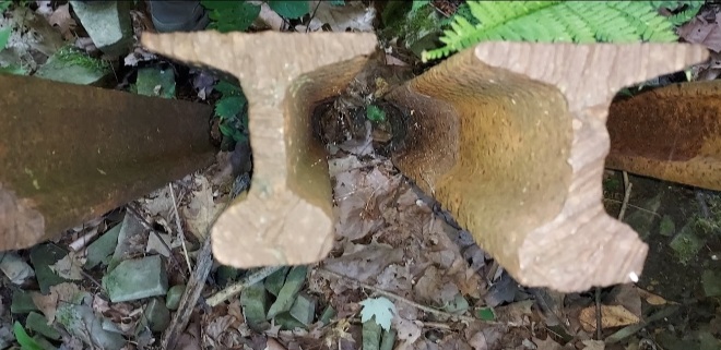

I made a rubbing if this rail profile and measured approximately:
Head 2 1/8"
Depth 4"
Base 3 3/4"
I believe this is related to an old quarry spur that would have connected to the C.C.C. & St. L. railroad.
Trying to estimate rail type/weight, perhaps age etc.

I have a section of Manx Norther Railway 56 lb/yd. steel rail on my desk which is also 4" high but wider in the head by 1/8" and the foot is 4" wide. My guess would be that yours is in the region of 50 - 55 lb/yd.
Ray.

According to this chart, you are looking at maybe 50# ASCE rail:
http://www.akrailroad.com/products/tee- ... ction-data

If that rubbing is indicative of the rail's profile, it would tell me that the rail is most likely wrought iron and probably dates from the 1850s to 1870s.

5607 is my best guess. 56#. An oddball. Ref. the bottom of this list: http://www.icrr.net/rails.htm

It this is rail from the 1880s, it is likely a pre-ASCE standard rail. We did a project using very, very used rail which had previously been at NatCap, just inside our new buildings. It was very close to 60AS, but annoyingly the fishing was 1/8" shorter and we didn't get as many joint bar pairs as we got sticks. I had to take 60AS bars and mill the top surface down to get a correct fit. The rail mill marks identified it as a Penn Steel 58# section, but didn't give an exact section number. An old Pennsylvania catalog page matched up exactly with the dimensions as Pennsylvania section number 7, a 58# section.
You are probably in a similar boat. If you can find any kind of surviving mill mark on the web that would give you a clue at least to the manufacturer. Trying to match up by dimensions when the rail is old and worn is difficult. Overall height is almost always diminished from nominal, and depending on side wear and if the rail was turned in service, head width is also suspect.
In theory you could trace the outline of the section, use a CAD program to compute the enclosed area, and then use the density of steel to figure out the nominal weight per yard.

Interesting, almost looks like the old iron pear rail. Over the years i have found pcs. of old iron rail in Ohio. Some were tossed over the right of ways due to breakage, used as pilings at river locations ect. I know where there is still a full pc. burried along a old quarry spur, that still has a rail chair attached at the one end. I know of another pc. burried in the ground at a old iron furnace in Southern Ohio. I have found several different sizes but its kind of hard to calculate the size due to wear, the years of rusting away in the elements or being burried. I have one 2 ft pc. I cut off a rail that was burried after being thrown off the side of the 1872 double stone arched LS&MS bridge at Wakeman, Ohio. It may have come off the previous wood trestle as the line dates to 1852 . It was one of the inner guard rails as the end is beat down to a taper. Its some pretty small stuff and is only 3 1/2" high but the other measurements are the same as the pc. you did the rubbing from. The various types of rail chairs they used at the rail joints are just as interesting.
