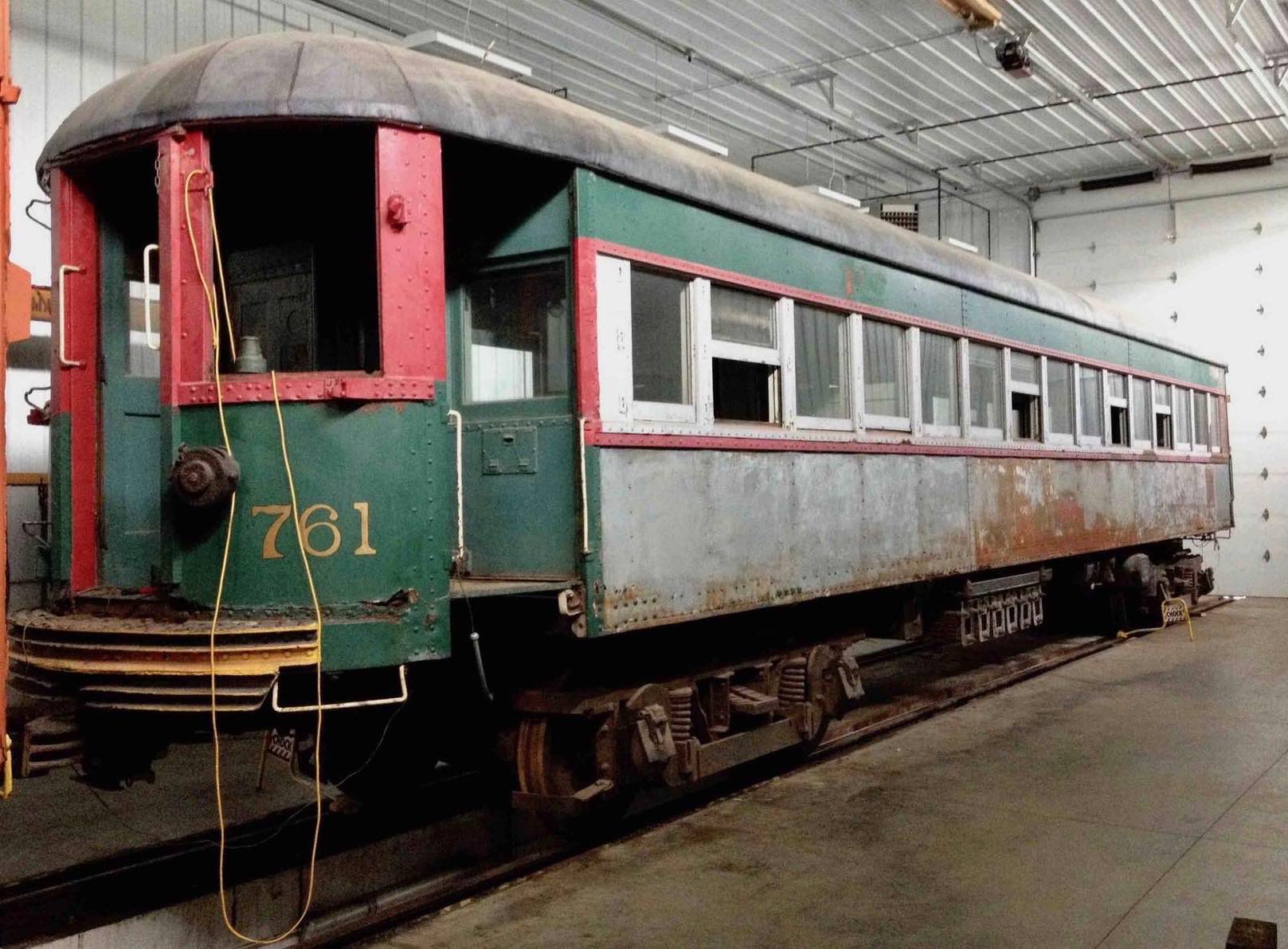

The East Troy Railroad Museum announced today that it is working to restore North Shore interurban Car #761 and South Shore interurban Car #6.
The museum acquired Car #761 from a Michigan museum in 2001 and started initial work to restore the car soon afterward. Efforts ground to a halt when volunteers discovered structural deterioration on the north end of the car. When a qualified welder joined the volunteer team in East Troy, the Board agreed that it was time to restart the restoration work.
In addition to the structural work, Car #761 needs body work, needs to be repainted inside and out, needs new flooring, needs the seats reupholstered, needs the electrical system cleaned, repaired and tested, needs the brake lines reinstalled to both control stands, needs new doors and new glass installed on the south end of the car, and needs the stairways reinstalled on both ends. The car was built by Standard Steel Car Co in 1930.

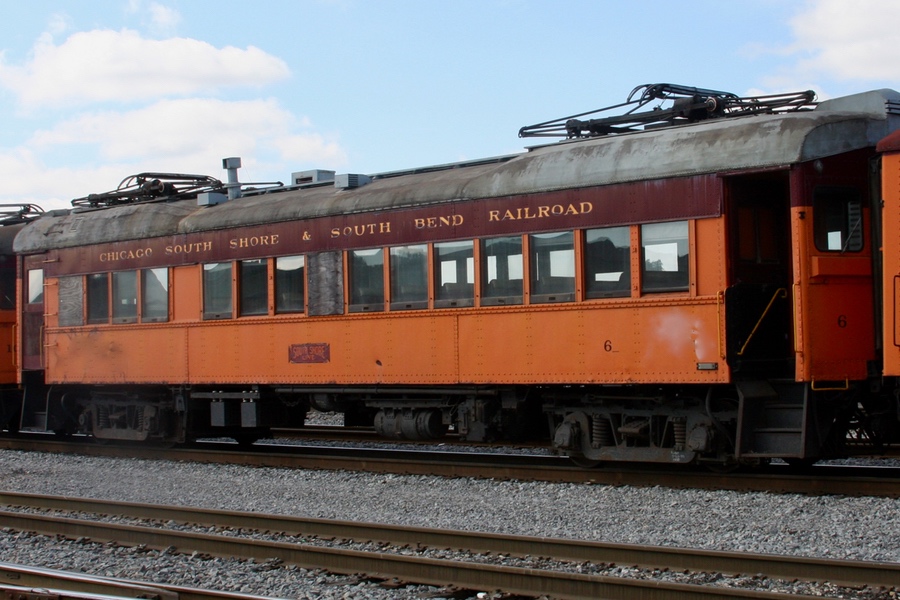

Car #6 needs to have its wheels and trucks refurbished, needs two traction motors rebuilt, needs its seats reupholstered, needs new flooring, some rewiring, and much cosmetic work to restore its appearance. The pantographs above the car must be removed and replaced by trolley poles, so the car can run on the East Troy Railway. A new canvas roof will also be installed. The car was built by the Pullman Car Co in 1926.

File comment: CSS&SB Car #6 in transit to East Troy in 2010

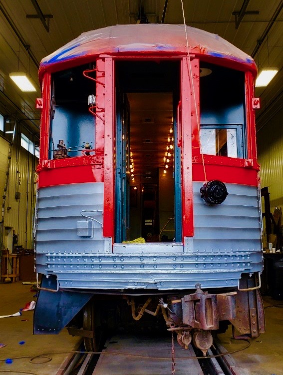

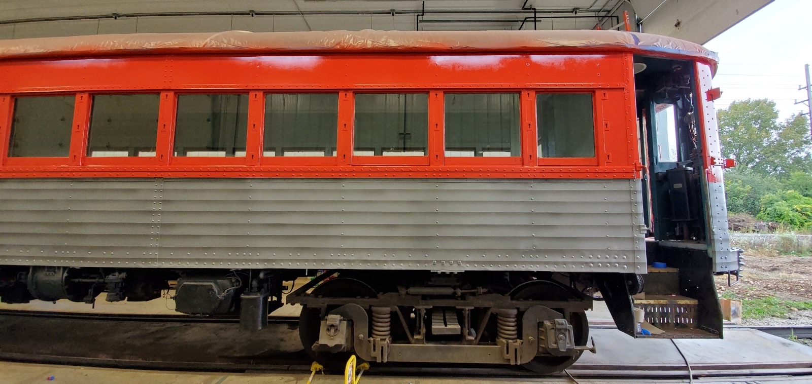

Update on North Shore Car 761 at the East Troy Railroad Museum:
The car is coming along nicely, as the nearby photos show. Structural problems on both ends have been repaired, the interior stripped and repainted, and the exterior recently received the classic Silverliner paint scheme. The railroad does plan to add the skirting common to Silverliner cars too. The hope is to operate this car on the line before the end of the calendar year.
File comment: Silverliner paint scheme looks great
File comment: East end of Car 761 at the end of September.

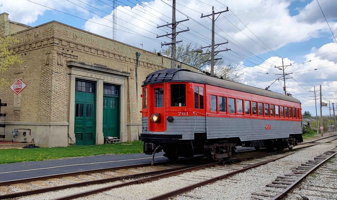

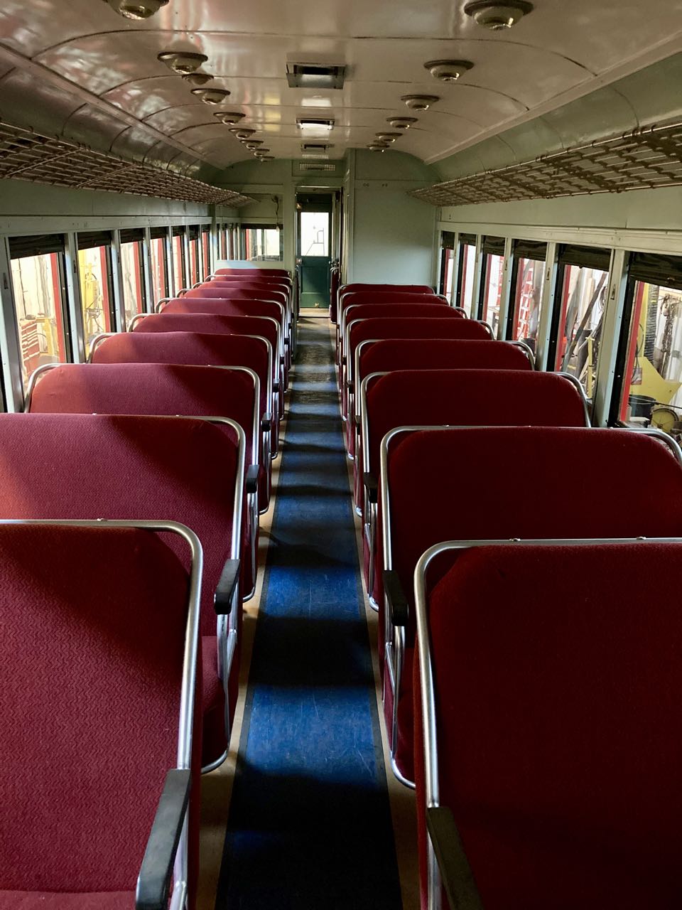

Chicago North Shore and Milwaukee Car 761 took its first test run last Sunday, April 28th. It performed well on its first trip on its own power since 1963. A few small issues were discovered and will be addressed in the coming weeks. The cars is looking great. We hope to announce a ribbon cutting event to publicly roll out the car soon. More photos can be seen on the East Troy Railroad Museum Facebook Page: https://www.facebook.com/EastTroyRR/
File comment: The interior of Car 761 looks like new!
File comment: Car 761 at the East Troy Depot on it's first test ride last Sunday, April 18th.
