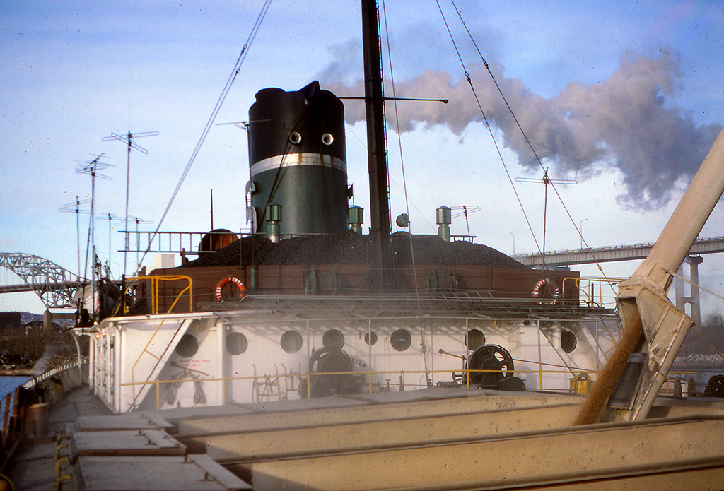

The coal-fired Great Lakes freighters had a bunkering hatch located up on the boat deck. Bunker coal was loaded from the same type of loading apparatus that typically loaded coal cargoes. The boats could fuel up at one of the Lake Erie coal loading ports, or there were several coal docks around the Lakes that existed solely for bunkering ships, such at Lime Island and Detour in the St. Marys River. There were also some bunkering vessels that delivered coal to ships in some of the lower lakes ports. As the number of coal burning vessels began to dwindle and many of the bunkering operations shut down, the remaining coal burners had to carry more coal to increase their range between bunkering. You would often see them with coal piled high on the boat deck next to the bunkering hatch, as seen on this 1988 shot aboard the 1916-vintage coal-burner Henry Steinbrenner.
File comment: Coal pile on the Henry Steinbrenner, 1988.
Most of the Great Lakes steamers built in the 1950s and 60s were built as oil burners, including the Ryerson and the ship that set the pattern for the 1950s lakers, the 1949 Wilfred Sykes. There were a few exceptions though, including the John Sherwin and the ill-fated Edmund Fitzgerald, which were both built as coal burners in 1958.
