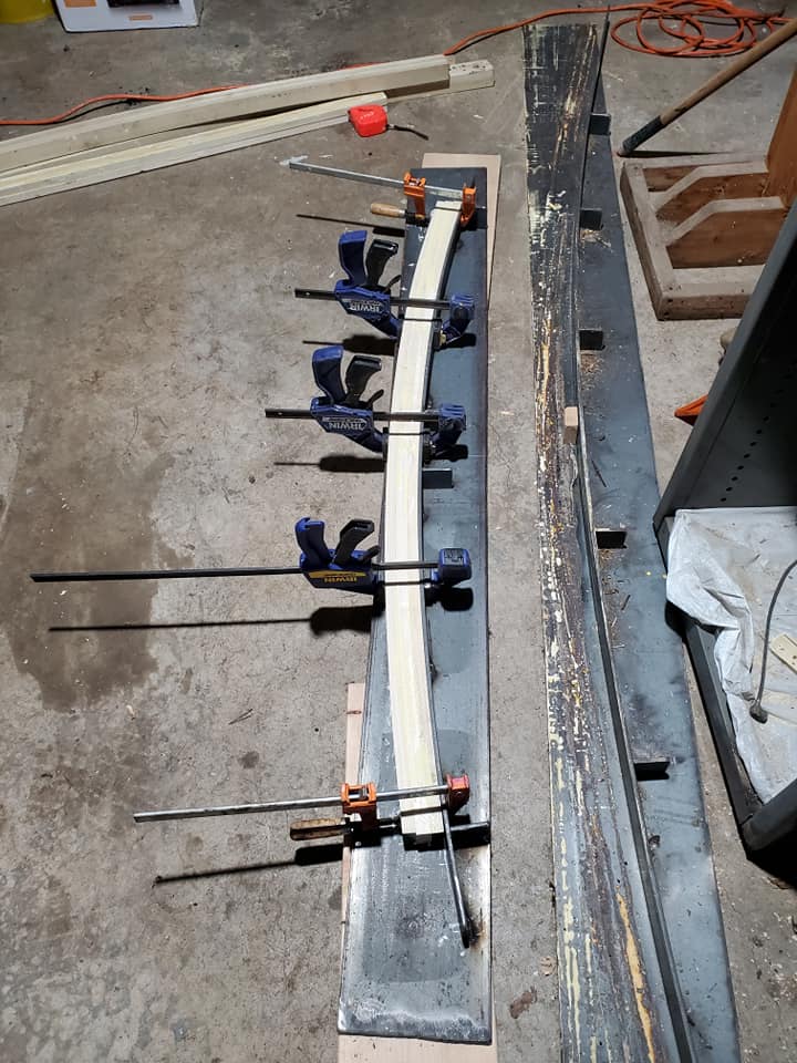

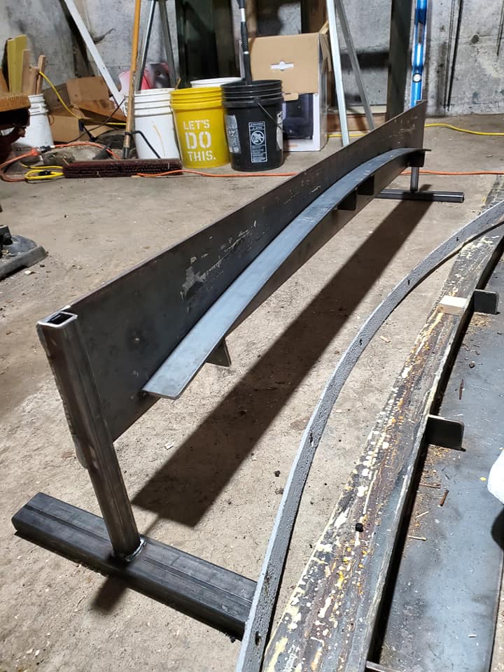

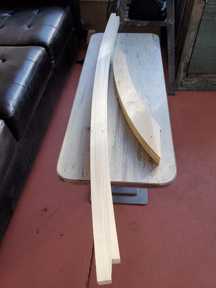

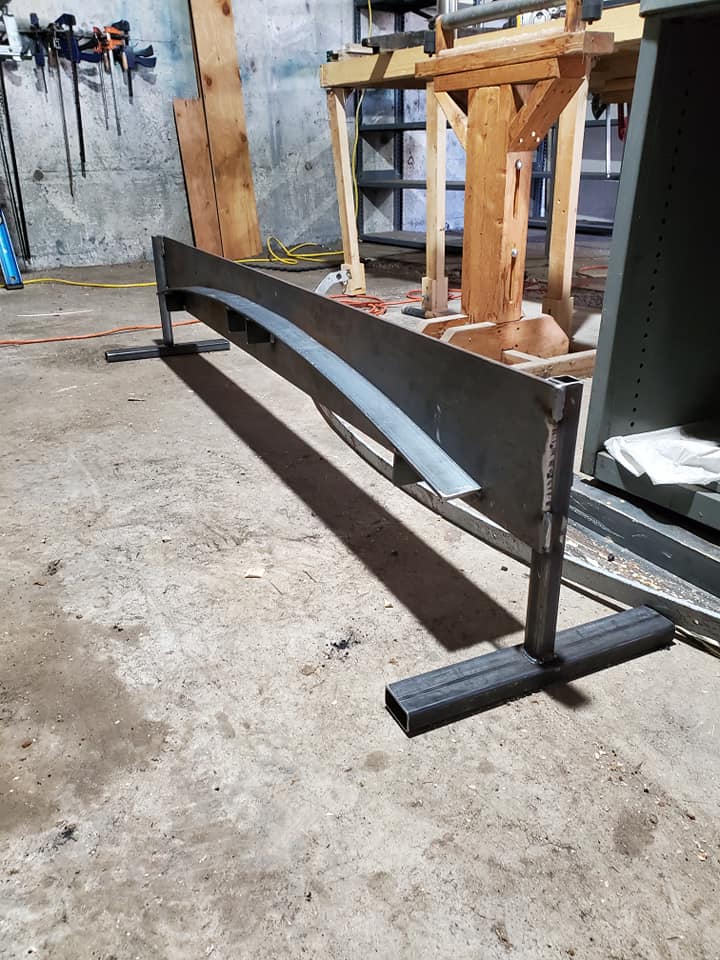

I have been experimenting with laminating carlines for different aspects of wood cars and cabooses, we made forms for the roof arches of the UP wood cabooses i own and now have a double form for a D&RGW narrow gauge car, also producing the lower carlines for the side roof of these cars on my duplicating machine, and for the Denver Trolley car we are restoring. Soon will be making a form for the cab roof braces for Porter 'Audrey' No6.
I basically did this due to the extreme waste and cost of finding full 2 inch oak boards for cutting one piece carlines.
This service is available from Vintage Rails Restoration for all projects involving this kind of process. Call me 307 221 2371 for info.

Mike,
What have you found you have to allow for 'spring back'?

Dennis Storzek wrote:
Mike,
Dependent on the material. a lot more spring back for fir than poplar, i like poplar a lot more for strength, on these 4ft 2 arches about 1/2 inch spring back.

How thin are the individual laminations being used?
