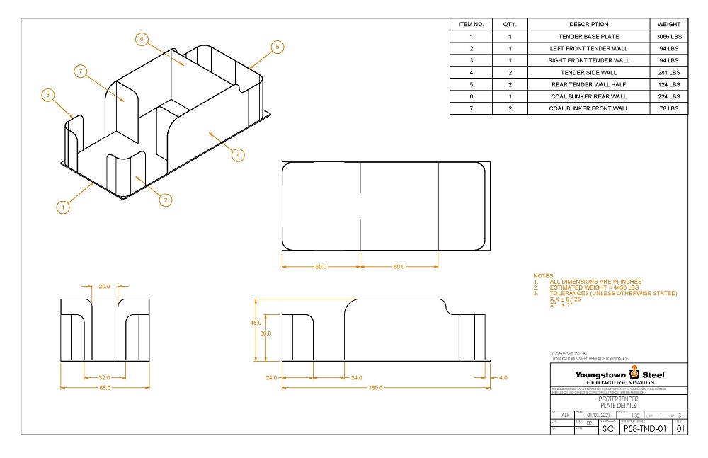

Assembly drawing for the new tender superstructure

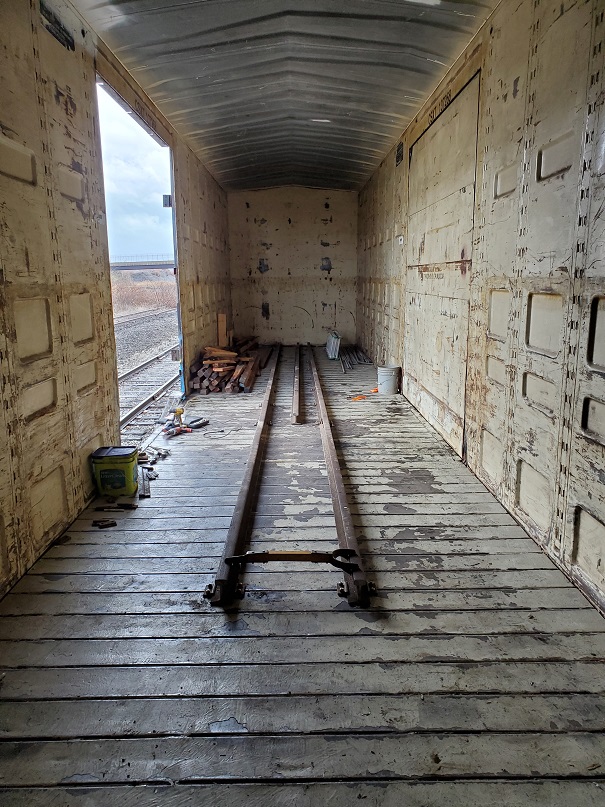

The new enginehouse with 24" gauge rails bolted to the floor. The new doors go on the far end.
