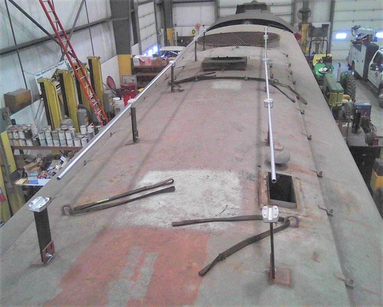

Bobb owns two former SP&S, nee' LIRR FA1's as well. While they are empty car bodies at present, transplant power systems will hopefully be applied for full restoration. That's a while off in the distance.
File comment: Faux PRR style trainphone antenna on LIRR 602. Tim Darnell photo.
File comment: Faux trainphone antenna on fomer LIRR, soon to be PRR 602. Tim Darnell photo.
