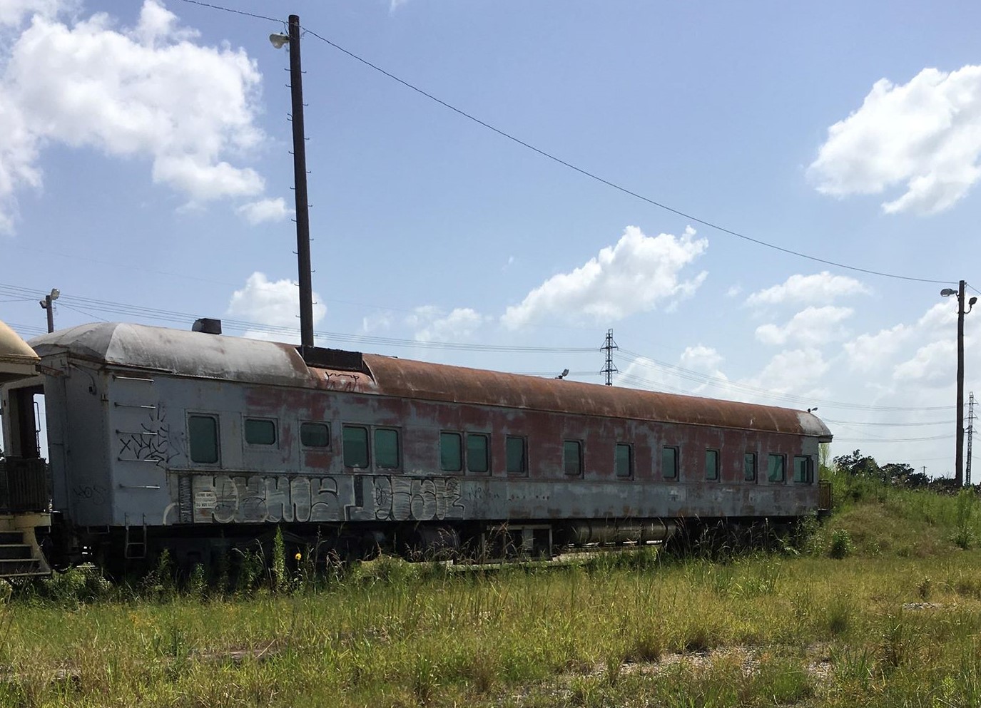

Some general information as to the condition of the DIXIE are as follows:
-The interior is somewhat complete. Trans Texas Rail had been working on refurbishing the DIXIE up to the time TTR lost its shop location at the old SP roundhouse here in SA. The majority of the electrical for conversion to HEP had been completed and only the interior electrical work remains.
-All of the interior furnishings have been removed. The original beds are rotted and have been disposed of. The dining room table and chairs are not in the car, nor are the other chairs from the lounge area.
-Due to recent events with the UPRR and miscommunications, the DIXIE was almost scrapped on us. As such, a remediation company had been called to determine whether there was any asbestos present in the car. Fortunately all the asbestos had been removed by TTR when they started the refurbishing process, however the company doing the remediation work removed all the Adlake windows from the car while trying to determine if the car was clear or not. We have all the window frames, but many of them suffered from "target practice" by local youth who thought it great to break the expensive glass. We will be needing to replace the glass in all but 5 windows who managed to survive.

This is the most current photo of the Dixie. -Gary

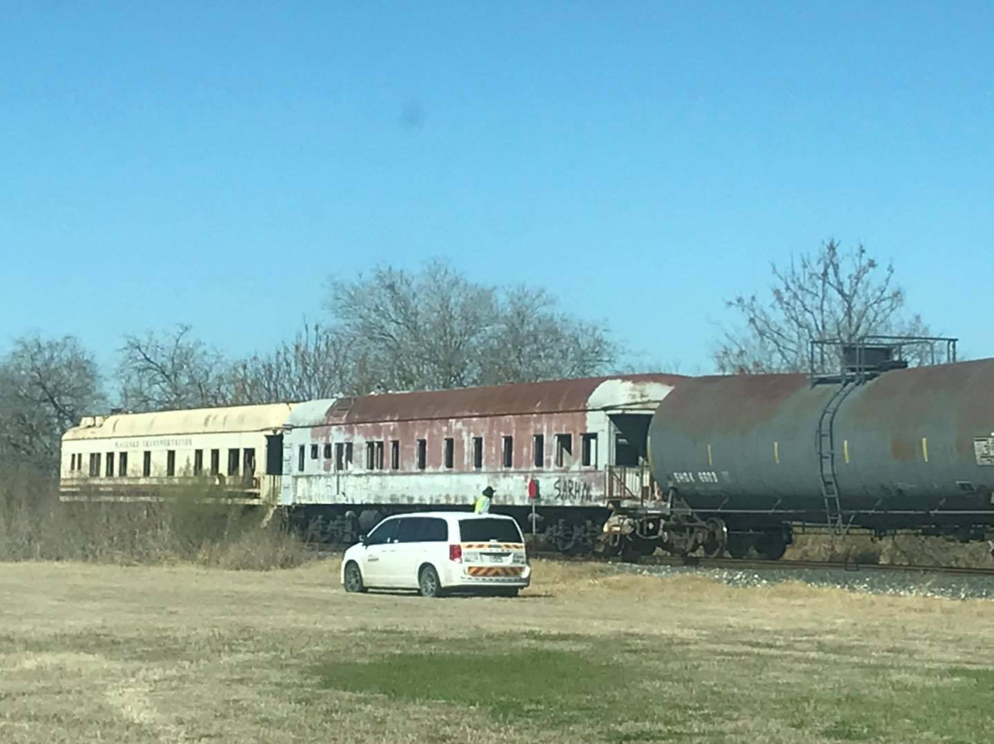

"San Antonio Railroad Heritage Museum We at the San Antonio Railroad Heritage Museum, would like to express our deepest thanks to the Union Pacific Railroad and to all the employees who helped orchestrate the move of the former SSW #1 “Dixie” and MKT 402 business cars. These cars are symbols of the rich heritage the Union Pacific Railroad is built upon. When restored, the SSW #1 “Dixie”, MKT 402, as well as the SP 127 “Alamo” will all be preserved pieces of what makes the Union Pacific the greatest railroad in the United States.
As President of SARHM, I am extremely grateful to the help of the local South Texas Service Unit management and employees who made this historic event possible. Without their hand, this move would not have been made possible. As such, when the SSW #1 “Dixie” and MKT 402 will both have plaques placed inside the cars both commentating the move by the Union Pacific Railroad and in thanks for their generosity as well.
I am looking forward to whats coming in SARHM’s future. With the possible acquisition of THREE locomotives, another passenger car and a caboose, we have exciting times ahead. Hopefully we will once again be able to work with the Union Pacific Railroad in preserving both Texas and the UPRR’s railroad heritage.
With much thanks,
Gary Rodriguez
President/CEO
San Antonio Railroad Heritage Museum"

There are around 90 photos of the interior of SSW #1 from two years ago on there, they opened for me using firefox. There also are 15 photos of what they describe as "MKT Business Car - Mallard", not sure if it is the same as MKT 402 but if it is the condition inside seems reasonable. Anyone know where the cream-colored paint scheme on MKT 402 came from?

Some additional information about MKT 402, copied and pasted from the "Surviving KCS passenger cars" thread: "Pullman Standard Business Car #101, originally- MKT #402. Reportedly sold to a private owner in Tulsa, circa 1968. Painted and re-lettered for Mallard Transportation "RPCX 101". Moved to Fayetteville, Arkansas for restoration in 2004. Reportedly located in Union Pacific’s East Yard in San Antonio, TX. Moved by UP to Alamo Junction Rail Park in Elmendorf, Texas on behalf of owner San Antonio Railroad Heritage Museum on 1/15/21. More to follow."
