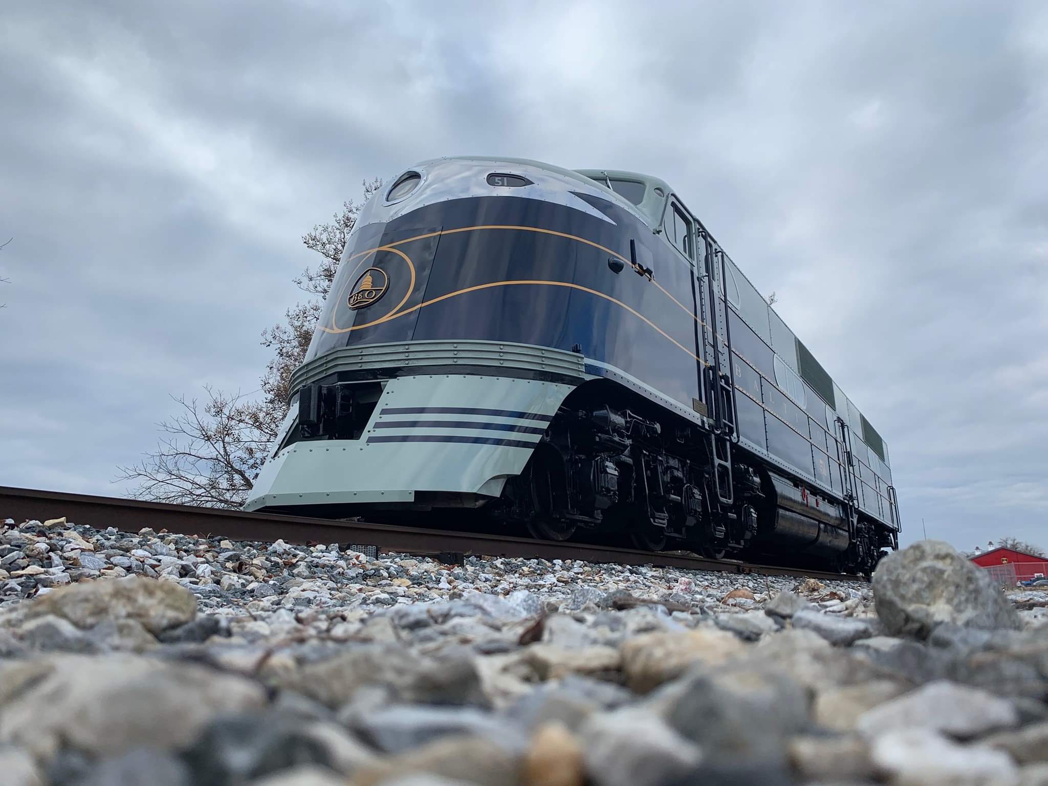

The B&O museum since COVID started have made an effort to release daily content on their social media pages regarding some of their locomotives, stock, or other various things. Today on what they call their “train talk”, they released information about the progress on cosmetically restoring B&O EA #51, famously the first E unit Diesel Locomotive, restored to As Built condition. According to them, the restoration has been completed, and the locomotive has apparently been moved back to its longtime location in the Car Shop.

It's absolutely beautiful. Note the recreation of the original style pilot, replacing the F until style pilot it wore late in its career. Also note the stainless trip piece on the nose. That took some real craftsmanship to recreate.

What a beauty. Wonderful work.
Is there anything inside the carbody?

The original Winton engines are inside, but the generators have been removed. The traction motors are also absent. I don’t know how complete the cab is.

The EA-EB's were rebuilt by EMD into E8Am-E8Bm's rated at 2000 HP instead of 2250. Were the generators and motors among the components that were rebuilt and installed on the E8's?
